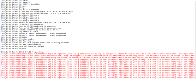

My customer encounters a very specific problem while using the 66AK2H14 on a custom board.
After connecting to the target, he runs the gel file, to initialize the SoC (very similar to the GEL by default on this version of CCSv910, ie log below). However, even if the DDR3 seems to be initialized properly, a DDR3 access (through memory browser or with a direct access through the ddr3A_memory_test () function for example) leads the CPU to crash
- emulator is XDS560V2STM and CCSv910
- CCS sends the error -1202 ie below. This error is not specified here https://software-dl.ti.com/ccs/esd/documents/ccs_debugging_jtag_connectivity_issues.html#device-hung
- JTAG tests prove a correct physical interconnection with the DDR.
- The supply voltage of both the CPU and the DDR has been tested and don't show any problem.
          -> How can a DDR access makes the CPU to crash ?
          -> Do you have any explanation or recommendations on tests to be carried out ?
          -> I saw a very similar post here https://e2e.ti.com/support/processors-group/processors/f/processors-forum/1014972/66ak2g12-what-s-this-error-message-of-ccs-ddr-access-by-memory-browser/3751531?tisearch=e2e-sitesearch&keymatch=ERROR%201202#3751531 but has not been answered properly, have you found a solution since then?
Geoffrey
Error connecting to the target: (Error -1202 @ 0x6E) Device core is hung. The debugger will attempt to forced the device to a ready state and recovered debug control, but your application's state will be corrupt. You should have limited access to memory and registers, but you may need to reset the device to debug further.
  • Here are two gel files my customer used to initialize the SoC for a 100 MHz DDR input frequency.
     Coral_4k_DDR1000_CORE100 -bb.gelCoral_4k_DDR1600_CORE100.gel
    Geoffrey

    C66xx_24: GEL Output: ********************************************************
    C66xx_24: GEL Output: PLL Control Register (PLLCR)
    C66xx_24: GEL Output: DDR3A_PLLCR:			0x000DC000 (Address: 0x02329018)
    C66xx_24: GEL Output: 	FRQSEL[19:18]:			PLL Reference clock ranges from 166MHz to 275MHz (3)
    C66xx_24: GEL Output: Note: PLL Reference Clock should be 1/4 of DDR data rate. (i.e. 400MHz -> 1600MTs)

    C66xx_24: GEL Output: DDR begin
    C66xx_24: GEL Output: XMC setup complete.
    C66xx_24: GEL Output: DDR3 PLL Setup ...
    C66xx_24: GEL Output: DDR3 PLL Setup complete, DDR3A clock now running at 800MHz.
    C66xx_24: GEL Output: DDR3 PHY Leveling Complete
    C66xx_24: GEL Output: DDR3A initialization complete
    C66xx_24: GEL Output: DDR done
    C66xx_24: GEL Output: Global Default Setup... Done.

    C66xx_24: GEL Output:  DX1GSR0:		0x00379CA0
    C66xx_24: GEL Output:  		[14:7] (Write Leveling Period): 	9
    C66xx_24: GEL Output:  		[23:16] (Read DQS Gating Period): 	55
    C66xx_24: GEL Output:  DX2GSR0:		0x00379CA0
    C66xx_24: GEL Output:  DX3GSR0:		0x00399CA0
    C66xx_24: GEL Output:  		[23:16] (Read DQS Gating Period): 	57
    C66xx_24: GEL Output:  DX4GSR0:		0x00379CA0
    C66xx_24: GEL Output:  DX5GSR0:		0x00399CA0
    C66xx_24: GEL Output:  DX6GSR0:		0x00379CA0
    C66xx_24: GEL Output:  DX7GSR0:		0x00379CA0
    C66xx_24: GEL Output:  DX8GSR0(ECC):	0x00399C80
    C66xx_24: GEL Output: Delay Values from Write Leveling Registers:
    C66xx_24: GEL Output:  DX0GTR:			0x00005002
    C66xx_24: GEL Output:  		[13:12] (Rank 0 WL Cycle Latency): 	1
    C66xx_24: GEL Output:  		[15:14] (Rank 1 WL Cycle Latency): 	1
    C66xx_24: GEL Output:  DX0LCDLR0:		0x0000000D
    C66xx_24: GEL Output:  		[7:0] (Rank 0 WL Delay): 		13
    C66xx_24: GEL Output:  		[15:8] (Rank 1 WL Delay): 		0
    C66xx_24: GEL Output:  DX1GTR:			0x00005002
    C66xx_24: GEL Output:  DX1LCDLR0:		0x00000015
    C66xx_24: GEL Output:  		[7:0] (Rank 0 WL Delay): 		21
    C66xx_24: GEL Output:  DX2GTR:			0x00005002
    C66xx_24: GEL Output:  DX2LCDLR0:		0x00000012
    C66xx_24: GEL Output:  		[7:0] (Rank 0 WL Delay): 		18
    C66xx_24: GEL Output:  DX3GTR:			0x00005002
    C66xx_24: GEL Output:  DX3LCDLR0:		0x00000013
    C66xx_24: GEL Output:  		[7:0] (Rank 0 WL Delay): 		19
    C66xx_24: GEL Output:  DX4GTR:			0x00005002
    C66xx_24: GEL Output:  DX4LCDLR0:		0x00000029
    C66xx_24: GEL Output:  		[7:0] (Rank 0 WL Delay): 		41
    C66xx_24: GEL Output:  DX5GTR:			0x00005002
    C66xx_24: GEL Output:  DX5LCDLR0:		0x00000038
    C66xx_24: GEL Output:  		[7:0] (Rank 0 WL Delay): 		56
    C66xx_24: GEL Output:  DX6GTR:			0x00005002
    C66xx_24: GEL Output:  DX6LCDLR0:		0x00000038
    C66xx_24: GEL Output:  DX7GTR:			0x00005002
    C66xx_24: GEL Output:  DX7LCDLR0:		0x0000003A
    C66xx_24: GEL Output:  		[7:0] (Rank 0 WL Delay): 		58
    C66xx_24: GEL Output:  DX8GTR:			0x00005000
    C66xx_24: GEL Output:  DX8LCDLR0:		0x00000000
    C66xx_24: GEL Output:  		[7:0] (Rank 0 WL Delay): 		0
    C66xx_24: GEL Output: Equivalent 90 degree phase shift in delay units, derived from measured period:
    C66xx_24: GEL Output:  DX0LCDLR1:		0x001B1B1C
    C66xx_24: GEL Output:  		[7:0] (Write Delay Shift): 		28
    C66xx_24: GEL Output:  		[15:8] (Read DQS Delay):		27
    C66xx_24: GEL Output:  		[23:16] (Read DQSN Delay): 		27
    C66xx_24: GEL Output:  DX1LCDLR1:		0x001C1B1C
    C66xx_24: GEL Output:  		[23:16] (Read DQSN Delay): 		28
    C66xx_24: GEL Output:  DX2LCDLR1:		0x001C1B1C
    C66xx_24: GEL Output:  DX3LCDLR1:		0x001C1B1C
    C66xx_24: GEL Output:  DX4LCDLR1:		0x001C1C1C
    C66xx_24: GEL Output:  		[15:8] (Read DQS Delay): 		28
    C66xx_24: GEL Output:  DX5LCDLR1:		0x001C1C1C
    C66xx_24: GEL Output:  DX6LCDLR1:		0x001C1C1C
    C66xx_24: GEL Output:  DX7LCDLR1:		0x001B1C1C
    C66xx_24: GEL Output:  DX8LCDLR1:		0x001B1C1C
    C66xx_24: GEL Output: Delay Values from Read DQS Gating Leveling Registers:
    C66xx_24: GEL Output:  		[2:0] (Rank 0 DQS Gating Latency): 	2
    C66xx_24: GEL Output:  		[5:3] (Rank 1 DQS Gating Latency): 	0
    C66xx_24: GEL Output:  DX0LCDLR2:		0x0000001E
    C66xx_24: GEL Output:  		[7:0] (Rank 0 RL Delay): 		30
    C66xx_24: GEL Output:  		[15:8] (Rank 1 RL Delay): 		0
    C66xx_24: GEL Output:  DX1LCDLR2:		0x00000027
    C66xx_24: GEL Output:  		[7:0] (Rank 0 RL Delay): 		39
    C66xx_24: GEL Output:  DX2LCDLR2:		0x00000025
    C66xx_24: GEL Output:  		[7:0] (Rank 0 RL Delay): 		37
    C66xx_24: GEL Output:  DX3LCDLR2:		0x00000029
    C66xx_24: GEL Output:  		[7:0] (Rank 0 RL Delay): 		41
    C66xx_24: GEL Output:  DX4LCDLR2:		0x00000046
    C66xx_24: GEL Output:  		[7:0] (Rank 0 RL Delay): 		70
    C66xx_24: GEL Output:  DX5LCDLR2:		0x00000045
    C66xx_24: GEL Output:  		[7:0] (Rank 0 RL Delay): 		69
    C66xx_24: GEL Output:  DX6LCDLR2:		0x0000003D
    C66xx_24: GEL Output:  		[7:0] (Rank 0 RL Delay): 		61
    C66xx_24: GEL Output:  DX7LCDLR2:		0x00000049
    C66xx_24: GEL Output:  		[7:0] (Rank 0 RL Delay): 		73
    C66xx_24: GEL Output:  		[2:0] (Rank 0 DQS Gating Latency): 	0
    C66xx_24: GEL Output:  DX8LCDLR2:		0x00000000
    C66xx_24: GEL Output:  		[7:0] (Rank 0 RL Delay): 		0
    C66xx_24: GEL Output: ****************************************************************************************************************

    EVM_ARM_GEL_evmk2x_log.txt
    arm_A15_0: GEL Output: Disabling MMU
    arm_A15_0: GEL Output: Disabling Caches
    arm_A15_0: GEL Output: Invalidate Instruction Caches
    arm_A15_0: GEL Output: Enabling non-secure access to cp10 and cp11
    arm_A15_0: GEL Output: Enabled non-secure access to cp10 and cp11
    arm_A15_0: GEL Output: Enabling SMP bit in ACTLR
    arm_A15_0: GEL Output: Enabled SMP bit in ACTLR
    arm_A15_0: GEL Output: Entering NonSecure Mode
    arm_A15_0: GEL Output: Entered NonSecure Mode
    Connecting Target...
    arm_A15_0: GEL Output: TCI6638K2K GEL file Ver is 1.89999998
    arm_A15_0: GEL Output: Detected PLL bypass disabled: SECCTL[BYPASS] = 0x00000000
    arm_A15_0: GEL Output: (3a) PLLCTL = 0x00000040
    arm_A15_0: GEL Output: (3b) PLLCTL = 0x00000040
    arm_A15_0: GEL Output: (3c) Delay...
    arm_A15_0: GEL Output: (4)PLLM[PLLM] = 0x0000000F
    arm_A15_0: GEL Output: MAINPLLCTL0 = 0x07000000
    arm_A15_0: GEL Output: (5) MAINPLLCTL0 = 0x07000000
    arm_A15_0: GEL Output: (5) MAINPLLCTL1 = 0x00000040
    arm_A15_0: GEL Output: (6) MAINPLLCTL0 = 0x07000000
    arm_A15_0: GEL Output: (7) SECCTL = 0x00090000
    arm_A15_0: GEL Output: (8a) Delay...
    arm_A15_0: GEL Output: PLL1_DIV3 = 0x00008002
    arm_A15_0: GEL Output: PLL1_DIV4 = 0x00008004
    arm_A15_0: GEL Output: PLL1_DIV7 = 0x00000000
    arm_A15_0: GEL Output: (8d/e) Delay...
    arm_A15_0: GEL Output: (10) Delay...
    arm_A15_0: GEL Output: (12) Delay...
    arm_A15_0: GEL Output: (13) SECCTL = 0x00090000
    arm_A15_0: GEL Output: (Delay...
    arm_A15_0: GEL Output: (14) PLLCTL = 0x00000041
    arm_A15_0: GEL Output: PLL has been configured (CLKIN * PLLM / PLLD / PLLOD = PLLOUT):
    arm_A15_0: GEL Output: PLL has been configured (122.879997 MHz * 16 / 1 / 2 = 983.039978 MHz)
    arm_A15_0: GEL Output: Switching on ARM Core 0
    arm_A15_0: GEL Output: Switching on ARM Core 1
    arm_A15_0: GEL Output: Switching on ARM Core 2
    arm_A15_0: GEL Output: Switching on ARM Core 3
    arm_A15_0: GEL Output: ARM PLL has been configured (125.0 MHz * 16 / 2 = 1000.0 MHz)
    arm_A15_0: GEL Output:  DISABLESTAT ---> 0x000007FF
    arm_A15_0: GEL Output: Power on all PSC modules and DSP domains...
    arm_A15_0: GEL Output: Power on all PSC modules and DSP domains... Done.
    arm_A15_0: GEL Output: WARNING: SYSCLK is the input to the PA PLL.
    arm_A15_0: GEL Output: Completed PA PLL Setup
    arm_A15_0: GEL Output: PAPLLCTL0 - before: 0x0x09080500	 after: 0x0x09080500
    arm_A15_0: GEL Output: PAPLLCTL1 - before: 0x0x00002040	 after: 0x0x00002040
    arm_A15_0: GEL Output: DDR begin
    arm_A15_0: GEL Output: XMC setup complete.
    arm_A15_0: GEL Output: DDR3 PLL (PLL2) Setup ...
    arm_A15_0: GEL Output: DDR3 PLL Setup complete, DDR3A clock now running at 666 MHz.
    arm_A15_0: GEL Output: DDR3A initialization complete
    arm_A15_0: GEL Output: DDR3 PLL Setup ...
    arm_A15_0: GEL Output: DDR3 PLL Setup complete, DDR3B clock now running at 800MHz.
    arm_A15_0: GEL Output: DDR3B initialization complete
    arm_A15_0: GEL Output: DDR done
    arm_A15_0: GEL Output: Entering A15 non secure mode ..
    arm_A15_0: GEL Output: A15 non secure mode entered

  • Geoffrey,
    Thanks for uploading the output.
    Let me look into it in detail and get back to you.
    Shankari G
  • Geoffrey,
    I am still comparing and analyzing the logs.....
    However, Just at a glance, the-top-level-difference between the EVM and the custom board from your output shows
     ----> From, "EVM_DSP_GEL_evmk2x_log.txt ----> "DDR3 PLL Setup complete, DDR3A clock now running at 666 MHz."
    ------> From "Custom_board_DSP_GEL_1000.txt" --->"DDR3 PLL Setup complete, DDR3A clock now running at 800MHz."
    Few questions :-
    1. In K2H EVM 4.0, the DDR3-SDRAM used is "Samsung_K4B4G1646D-BCK0". In the custom board, the same memory module is used?
    If , no, would you please specify the part used?
    ("The data sheet timing from the devicespecific SDRAM also needs to be referenced to extract critical timing parameters", So that we can check the DDR3 Memory Controller Registers and SDRAM Configuration. )
    2. All the custom units fails with the same error ? or few units?
    3. As I could see, that the memory modules are detachable from the k2H EVM, Is it possible to detach the "Samsung-memory module" from the Ti-EVM and use it on your custom board and check?. ( By this way, you can retain the same timing parameters mentioned in the TI-K2H-EVM-gel file)
    Few informations:-
    1. A diagnostic gel is available for DDR3 test. I have attached here, "Keystone2_DDR_Debug_v1_4.gel" Download the zip, below.
    sprac04.zip
    2. A general diagnostic gel for all K2x-EVM:- 4075.66AK2H12-diag.gel Please note that this gel is for K2H12.
    Please do run these diagnostics and check whether it helps in detecting the cause of the problem.
    Reference docs: ( you might have already referred)
    1. Keystone II DDR3 Initialization guide - https://www.ti.com/lit/an/sprabx7/sprabx7.pdf
    2. Keystone II DDR3 Debug Guide - https://www.ti.com/lit/an/sprac04/sprac04.pdf
    Shankari G
  • Hi M.Shankari
    Answers to questions :
    0 - note that  from "custom  board_DSP_GEL_1000.txt" the output message is not "DDR3 PLL Setup complete, DDR3A clock now running at 800MHz." as you wrote but "DDR3 PLL Setup complete, DDR3A clock now running at 500MHz. See file above.
    1 - The board uses MT41K256M16TW-107 XIT chips. There is no module. Chips are directly soldered on the main PCB
    2 -All the units don"t fails. Only few
    3 - see 1)
    Comments to informations :
    1- The "Keystone2_DDR_Debug_v1_4.gel" was used to generate the reports sent by M.Ficara
    REgards
  • Bruno,
    Thanks for the details on the "MT41K256M16TW-107 XIT ".
    Let me try to check the timing parameters of this chip w.r.t the custom gel file.
    There is a typo error, when I mentioned the file name. It is supposed to be your "Custom_board_DSP_GEL_1600.txt".
    This runs .....at 800 MHz.  "DDR3 PLL Setup complete, DDR3A clock now running at 800MHz."
    >>>All the units don't fails. Only few
    This implies, that the problem, most likely, on the hardware-side.
    Usually, If, it is, on the software configuration on DDR3 controller registers and SDRAM, all the units should fail.
    Let me loop in hardware team too.
    Shankari G
  • Geoffrey,
    I verified the controller registers and these are my observations....
    Micron-memory chip,"MT41K256M16TW-107 XIT" -- > 4G 256Mx16 FBGA.
     1. For DDR_SDCFG register value, Please ask customer to look into the datasheet page no: 2 of Micron memory chip.
    The page size for 256 Meg x 16, it is 2 KB and not 1 KB. So, the value will get changed into "0x6200CE63" ( bit 0 :1)
    2. For DDR_SDTIM1 register value, the t_RRD value will be 7 ( bit 4 : 9) and hence "0x166C9875". The customer mentioned as 6. Please refer to page no:85 of Micron memory chip.
    3.  I have to still check the PHY register values.  Will post once done.
    4. Do they use DDR3L or DDR3? ( Because, the register values in their gel shows DDR3-type but the datasheet they referred has the values of DD3L ) Please confirm....
    5. Attached the calculation spread sheet, I used for DDR3 and the datasheet of Micron chip, I referred for derivation of register values.
    SDRAM Register
    Address (hex)
    Value (hex)
    Customer Value
    Reason
    DDR_SDTIM1
    21010018
    166C9875
    166C9865
    x16 ( 2KB page size) t_RRD value = 7 and not six. Please refer to page no: 85 in data sheet of Micron chip
    DDR_SDTIM2
    2101001C
    00001D4A
    00001D6B
     Edited - Seems to be incorrect
    DDR_SDTIM3
    21010020
    435DFF53
    435DFF53
    Seems to be right
    DDR_SDTIM4
    21010028
    543F0CFF
    543F0CFF
    Seems to be right
    DDR_SDCFG
    21010008
    6200CE63
    6200CE62
    Page size = 2KB --> 2048 --> register value in hex = 3
    DDR_SDRFC (normal)
    21010010
    00001869
    NIL ( ext )
    DDR_SDRFC
    (ext temp)
    21010010
    00000C34
    00000C34
    Seems to be right
    DDR_ZQCFG
    210100C8
    70073200
    70073200
    Seems to be right
    Calculation spread sheet:
    Shankari G
  • Hi M.Shankari,
    Thank you for your feedback,
    I am not sure to fully agree your comments, May be I am wrong. Tell me.
    1 - The Micron datasheet do specifies a page size of 2KB meaning for 2K Bytes. BUT in the the DDR3 controller "hspruhn7c" document , the PAGESIZE parameter is expressed in terms of Words, therefore 1K Words. You can look at table2-4 where "10 column address bits" (this is the case for our DDR3 16bits wide chip) requires a value of 2 for PAGESIZE parameter. This appears also in table 3-1  where PAGESIZE=2 is chosen to "select 1024 WORDS page size". This is also found in the SDCFG description : "2 = 1024-word page requiring 10 column address bits." It is question of WORDS and not BYTES.
    May be it is a miss-understanding from my side. Please confirm.
    2 - The T_RRD value to be written in the SDTIM1 register should be equal to (T_faw/4Tck)-1. The DDR datasheet specifies a maximum T_faw of 35 ns (see page 96 of the datasheet, applying to 1866 speed grade - -107 chip version)  therefore resulting in (35/1.25*4)-1 = 6.
    May be there is a confusion between the 1866 speed grade of the chip and the effective running speed used on the board.
    Please confirm the correct value.
    4- From time to time we switched between DDR3 and DDR3L parameter with the hope of getting better behaviour but nothing positive never happened. Apparently we kept this parameter to DDR3. But I can guaranty that coming back to DDR3L does not solve the current problem we have.
    There is also a potential confusion between the characteristic of the chip that we use : a DDR3L component, and the way it is used - being DDR3-  due to 1V5 power supply. The "hspruhn7c" is not that clear on the setting to put here.
    Please would you confirm the correct setting.
    By the way could you also explain what are the 66ak2h14 physical characteristics that change depending upon the DDR3 parameter value ?
    With best regards,
    Bruno
  • Bruno,
    Point no:2:
    The t_RRD will be '7' for both the speed grade, DDR3L-1866 and DDR3L-1600 as the TCK will change as 1.071 ns and 1.25 ns respectively.
    For DDR3L-1866 speed grade --->  (T_faw/4Tck)-1 = 7
                                  (T_faw/4Tck)-1.
                               => T_faw = 35 ns for DDR3L-1866
                               => Tck = 1.071 ns ( DDR3L- 1866 ---> DDR3 output clock frequency = 933 MHz --> Tck = (1/(933*1000000) = 1.071 ns)
                             Therefore,  (T_faw/4Tck)-1
                                               = ( 35 / (4* 1.071 ) ) - 1
                                               =  ( 35 / 4.284) - 1
                                              =  7.16
                                              ~ 7
                                  (T_faw/4Tck)-1 = 7
    For DDR3L-1600 speed grade --->  (T_faw/4Tck)-1 = 7
                                  (T_faw/4Tck)-1.
                               => T_faw = 40 ns for DDR3L-1600
                               => Tck = 1.25 ns ( DDR3L- 1600 ---> DDR3 output clock frequency = 800 MHz --> Tck = (1/(800*1000000) = 1.25 ns)
                                               = ( 40 / (4* 1.25 ) ) - 1
                                               =  ( 40 / 5) - 1
                                              =  7
                                  (T_faw/4Tck)-1 = 7
    Point No:4:
    In "spruhn7c" page no: 90, the setting is given.
    According to DDR3 or DDR3L,
    In register, DDR3_PGCR1, field value of IODDRM (bit 7:8) have value 1 for DDR3 and 2 for DDR3L.
    Have they set this value and tried? What value they set here?
    For deriving the DDR3-register values, what speed grade is used? Either 1600 or 1866? so that, I can verify the PHY register values?
    1. The output you posted here are for DDR3L-1600 with 800 MHz.
                   -----> which means, shall I calculate the values for "DDR3L-1600 -125 "  or for "DDR3L-1866 - 107"
    2. In the datasheet, The part number 107 implies, the speed grade as DDR3-1866 with "tCK– 1.07ns @ CL = 13"
    but the speed grade DDR3-1600 is used by you with "tCK1.25ns @ CL = 11 (DDR3-1600) -125 in your gel output.
    Which one you meant to use?
    Point no:1
    10 column address bit is enough to access the 2KB page size. Let the hex value be 2.
    ( 2 ^ 10 = 1024 = 1K ) --> 1K x4     = 4K bits.
                                        --> 1K  x16  = 16K bits = 2048 bytes --> 2KB per page.
    Please confirm the below design parameters, So that I can proceed with PHY register values .......
    Design Value Units
    DDR3 Output Clock Frequency 800.000 MHz
    DDR3 Data Rate 1600.000 MT/s
    DDR3 Output Clock Period 1.250 ns
    Device MT41K256M16 125 (1600)
    Speed Grade 1600 MT/s
    Shankari G
  • Hi M.Shankari,
    - Point2 : OK, understood.
    - point 4.0 : as explained both DDR3 and DDR3L settings were tried without visible difference in the result.We will set what you recommend

  • essai-DDR1600_CORE100 - TI.gel
    Hi M.Shankari,
    I have modified the gel (see file) and put there all values calculated in your 8562... spreadsheet.
    The PNG file is a snapshot of what we see after opening a memory window.
    Note that the Error windows does not appear always right upon opening the memory window. Some amount of time may occur - in continuous refresh mode - before the crash ( 1 or 2 minutes let's say)
    Bruno

  • essai_gel_result.txt
    C66xx_24: GEL Output: JCL modifcation, TCI6638K2K GEL file Ver is 1.70000005
    C66xx_24: GEL Output: Detected PLL bypass disabled: SECCTL[BYPASS] = 0x00000000
    C66xx_24: GEL Output: (3a) PLLCTL = 0x00000040
    C66xx_24: GEL Output: (3b) PLLCTL = 0x00000040
    C66xx_24: GEL Output: (3c) Delay...
    C66xx_24: GEL Output: (4)PLLM[PLLM] = 0x00000017
    C66xx_24: GEL Output: MAINPLLCTL0 = 0x0B000000
    C66xx_24: GEL Output: (5) MAINPLLCTL0 = 0x0B000000
    C66xx_24: GEL Output: (5) MAINPLLCTL1 = 0x00000040
    C66xx_24: GEL Output: (6) MAINPLLCTL0 = 0x0B000000
    C66xx_24: GEL Output: (7) SECCTL = 0x00090000
    C66xx_24: GEL Output: (8a) Delay...
    C66xx_24: GEL Output: PLL1_DIV3 = 0x00008002
    C66xx_24: GEL Output: PLL1_DIV4 = 0x00008004
    C66xx_24: GEL Output: PLL1_DIV7 = 0x00000000
    C66xx_24: GEL Output: (8d/e) Delay...
    C66xx_24: GEL Output: (10) Delay...
    C66xx_24: GEL Output: (12) Delay...
    C66xx_24: GEL Output: (13) SECCTL = 0x00090000
    C66xx_24: GEL Output: (Delay...
    C66xx_24: GEL Output: (14) PLLCTL = 0x00000041
    C66xx_24: GEL Output: PLL has been configured (CLKIN * PLLM / PLLD / PLLOD = PLLOUT):
    C66xx_24: GEL Output: PLL has been configured (100.0 MHz * 24 / 1 / 2 = 1200.0 MHz)
    C66xx_24: GEL Output: Switching on ARM Core 0
    C66xx_24: GEL Output: Switching on ARM Core 1
    C66xx_24: GEL Output: Switching on ARM Core 2
    C66xx_24: GEL Output: Switching on ARM Core 3
    C66xx_24: GEL Output: ARM PLL has been configured (100.0 MHz * 28 / 2 = 1400.0 MHz)
    C66xx_24: GEL Output:  DISABLESTAT ---> 0x000007FF
    C66xx_24: GEL Output: Power on all PSC modules and DSP domains...
    C66xx_24: GEL Output: Power on all PSC modules and DSP domains... Done.
    C66xx_24: GEL Output: WARNING: ALTCORECLK is the input to the PA PLL.
    C66xx_24: GEL Output: Completed PA PLL Setup
    C66xx_24: GEL Output: PAPLLCTL0 - before: 0x0x098804C0	 after: 0x0x09080500
    C66xx_24: GEL Output: PAPLLCTL1 - before: 0x0x00000040	 after: 0x0x00002040

  • Hi M SHANKARI,
    Sorry for the delay.
    I modified the GEL as per requested, which results in various errors during levelings
    See files
    global_default_setup_silent.txt
    C66xx_24: GEL Output: No initialization performed since bootmode = 0x00000004
    C66xx_24: GEL Output: You can manually initialize with GlobalDefaultSetup

    the modified GEL with PGCR0, and PGCR1 always gives leveling errors.
    With PGCR0, PGCR1 initial values the strange thing is that no errors are detected after the 1st "global_default_setup_silent' execution. But errors happen after a 2nd "global_default_setup_silent' launch (DX2GSR0[24], DX2GSR0[6],DX3GSR0[24], DX3GSR0[6], then disappear on the 3rd launch..... and so on.
    best regards,
    Bruno

    With this gel, we will be completing the verification on the software-side configuration.
    Meanwhile, may be, consider focusing on the following, as per the debug gel notes [ ( 66AK2H12-diag.gel ) from "sprac04.zip" ] on the levelling errors.
    * When a leveling error occurs, it usually means one of two things:
    * 1) (less likely) The physical layout has been done incorrectly to the point where the
    * leveling hardware's own margin cannot account for it.
    * 2) (more likely) The DRAM timing configuration is incorrect.
    * 3) (most likely) A power supply, clock, or DDR3 PLL is misconfigured for the desired
    * DDR operational mode.
