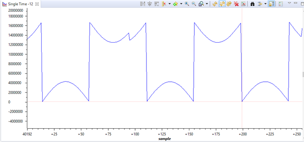

I have been stuck on this for long. I am making changes to the loopback example provided for AUDK2G, the audio daughter card for K2G - I get my input audio input which is a 500Hz sine wave and store it in an int32_t array. I plot this data (real-time) on CCS graph and this is what I see:
As seen, the negative part of the waveform appears in the positive part on the top. FYI - I have also made sure that I am plotting the data correctly, i.e, as a 32 bit signed integer. I am not sure why my data is getting written into the input buffer in this way? As a result, when I try to perform any audio processing, things go bad. I need help to know what's going on.
I have followed steps discussed on this post to make sure I am fetching audio samples correctly. I have been able to successfully de-interleave data and I am also able to direct audio from different input channels to the output ports that I desire (this proves that I am indeed reading the data correctly).
I am providing my code below for reference. It is the mcasp_cfg.c file. To find my lines of code, go to line 549. I am plotting the err_block array in the figure above. This array is assigned in line 554.

        input = (int32_t *)rxBuf[grxFrameIndexCount];
        output = (int32_t *)txBuf[gtxFrameIndexCount];
        int i, j=0;
        for(i=0; i<BUFSIZE * RX_NUM_SERIALIZER/sizeof(int32_t); i++){
            if (i%8 == 0){
                err_block[j] = input[i];
                output[i] = input[i];
//                aud_write("%d \n", BUFSIZE);
                j++;

  • I think I figured out why. Let me know if I am wrong.
    Here's why I was facing the issue:
    The ADC on the audio daughtercard has a 24bit ADC. This means that values that I will get on the port will range from 0 to 2^24 - 1. Now if I simply typecast a 32 bit unsigned int value from the MCASP to 32 bit int, there will be no change in the waveform. Therefore, I explicitly need to convert the values considering a 24 bit ADC.
    Yes, I think you've found the problem and your solution is a good one.
    Jianzhong
