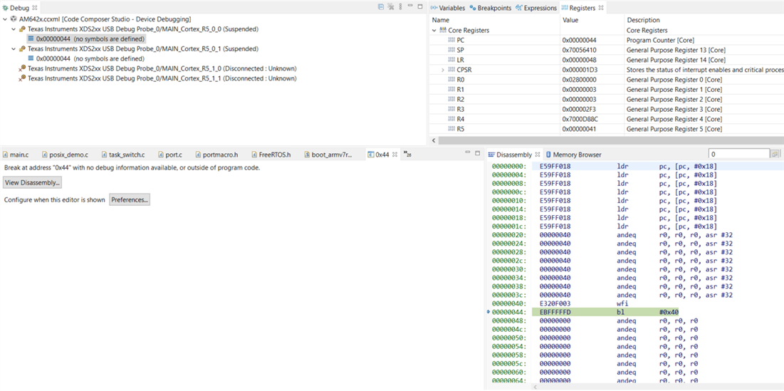

I'm working on a AM64x evaluation board TMDS64GPEVM, running FreeRTOS with mcu_plus_sdk_am64x_08_00_00_21.
This is a general question about .vectors section.
After powering up the board and connecting with XDS200 to R5_0_0 and R5_0_1 the memory at address 0x0 from the perspective of both core0 and core1 looks like this:

When connecting to core0 and loading an image I can see the vectors section properly loaded in address 0x0.
When connecting to core1 and examining the memory it looks like the image is properly loaded. I can see initialized variables and structures.
However, from core1 perspective the vector doesn't seem to be loaded.
How come it not visible from core1?
What is responsible for initializing this particular piece of memory? where is this code?
