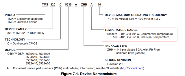

Hi Team
Previously we are using TMS320C5535AZHHA10 to design our product.
But we can see the following document mentioned the replacement model of TMS320C5535AZHHA10  is TMS320C5535AZHHA10  .
TMS320C5532/C5533/C5534/C5535 MicroStar BGA Discontinued and Redesigned.
e2e.ti.com/.../tms320c5535-tms320c5535azhha10-last-time-buy
But recently we found TMS320C5535AZAYA10 is out of stock. And after double check with local distributor they have plenty of TMS320C5535AZAY10 .
We can see the difference between TMS320C5535AZAYA10 and TMS320C5535AZAY10 is the temperature range .
Blank =–10 ° C to 70° C, Commercial Temperature
A =–40° C to 85° C, Industrial Temperature
Our product originally designed for commercial use but not for Industrial scenario.
Would it be possible to use TMS320C5535AZAY10 for our design ?
