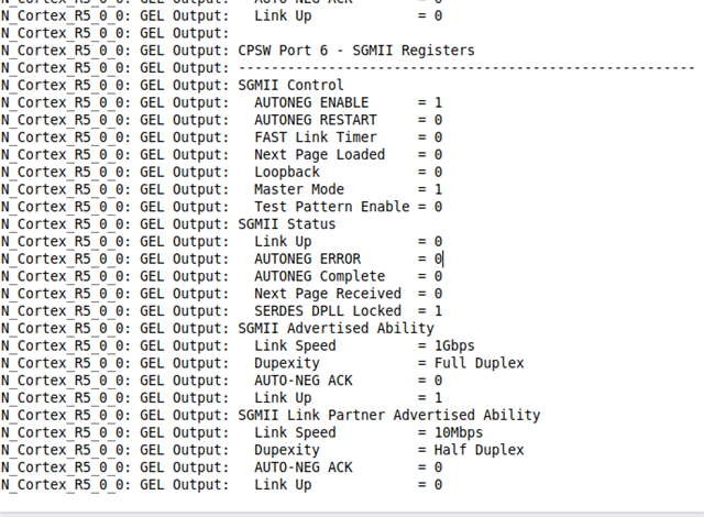

DRA829J: CPSW9G serdes4_0 clk src register could not write , program stuck at sgmii link state check
Part Number: DRA829J
I tried to debug mac to mac on SGMII port 5 & port 8.
I configured the SGMII mode to ENET_MAC_SGMIIMODE_SGMII_FORCEDLINK.
And I found SGMII port5 always stay at 'get SGMII status' as below:
There is no error information output in UART. And the value of register '0C000514h' is 0x00000030.
The SGMII port8 is the same as port5 and always stay at 'get SGMII status', but the value of register '0C000814h' is 0x0000003a.
I found the PLL of port8 sometime can't be locked,  and sometimes can be locked.
Above all, the SGMII5 & 8 cann't link up. Do you have any suggestions to handle this issue? Thank you!
And for above if there is anything wrong, please tell us and I will try to debug it.
Lan

    In addition to ethfw, we also test the loopback demo.
    When we set loopback level to mac loopback, the test result is PASS,  as following:
    But when we set loopback level to PHY loopback, the SGMII can't link up. The register status is following:
    We can see that the SerDes PLL is locked, and the SGMII Advertised Ability is correct. But the SGMII Link Partner Advertised Ability is wrong.
    At the PHY side, we have set the advertised ablitily to 1Gbps/Full Duplex. And now SGMII5/6 can't link up. We want to know how to debug and
    handle this issue(SGMII 5/6 can't link up). Please help us and give us some debug suggestion, Thanks a lot.
