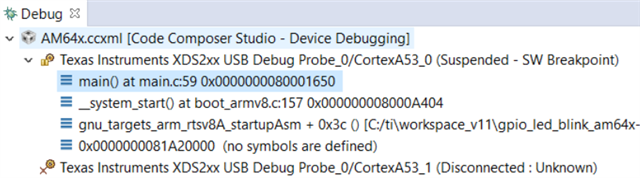

#4. Load program take gpio_led_blink_am64x-evm_a53ss0-0_freertos_gcc-aarch64 as example,
#5. it can run to end, exit as below.

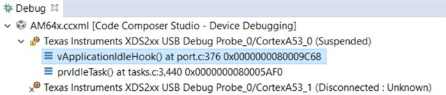

#6. reload the same .out, it will hang as below.
#7. To run A53 example, need to power cycle the board, and load js (sysfw.bin) each time?
