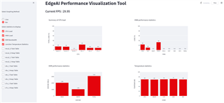

3. Is there any way to get a log file of utilized resources during specific inference run on the TDA4 platform?
