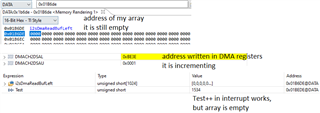

  • I will not create new forum question but i still have problem with DMA. Despite the setting DMA registers properly (I hope so) module does not transfer data from I2S to my array. I know that I have good destination and source address, interrupt function also works. But still my array is empty. What did I wrong? Below I insert my code with screenshots from debug mode.
    Uint16 i2sDmaReadBufLeft[1024]; //my array
    Uint16 Test=0;  //variable for testing interrupt
    // in main I call function initialize_dma
    // codec works properly, I show this on a screenshot
    TEST_STATUS initialize_dma(void){
        status = DMA_init();
        //Config left read
        dmaConfig.pingPongMode = CSL_DMA_PING_PONG_DISABLE;
        dmaConfig.autoMode     = CSL_DMA_AUTORELOAD_ENABLE;
        dmaConfig.burstLen     = CSL_DMA_TXBURST_1WORD;
        dmaConfig.trigger      = CSL_DMA_EVENT_TRIGGER;
        dmaConfig.dmaEvt       = CSL_DMA_EVT_I2S2_TX;
        dmaConfig.dmaInt       = CSL_DMA_INTERRUPT_ENABLE;
        dmaConfig.chanDir      = CSL_DMA_READ;
        dmaConfig.trfType      = CSL_DMA_TRANSFER_IO_MEMORY;
        dmaConfig.dataLen      = 1024;
        dmaConfig.srcAddr      = (Uint32)&CSL_I2S2_REGS->I2SRXLT1;
        //dmaConfig.destAddr       = (Uint32)(i2sDmaReadBufLeft); this gives random address
        IRQ_globalDisable();
        IRQ_clearAll();
        IRQ_disableAll();
        IRQ_setVecs((Uint32)&VECSTART);
        IRQ_clear(DMA_EVENT);
        IRQ_plug (DMA_EVENT, &dma_isr);
        IRQ_enable(DMA_EVENT);
        IRQ_globalEnable();
        dmaHandleRxL = DMA_open((CSL_DMAChanNum)6,&dmaObj, &status);
        status = DMA_config(dmaHandleRxL, &dmaConfig);
        Uint32 buffor = (Uint32)i2sDmaReadBufLeft;  //adding properly address manually
        dmaHandleRxL->dmaRegs->DMACH2DSAL = (Uint16)(buffor);
        dmaHandleRxL->dmaRegs->DMACH2DSAU = (Uint16)(buffor >> 16);
        //start channel with sync
        dmaHandleRxL->dmaRegs->DMACH2TCR2 |= 0x8004;
        return (status);
    interrupt void dma_isr(void)
        int ifrValue;
        ifrValue = CSL_SYSCTRL_REGS->DMAIFR;
        CSL_SYSCTRL_REGS->DMAIFR |= ifrValue;
        Test++;
    I2S Configuration
    DMA1 ConfigurationDMA1 Trigger ConfigurationArray is still empty but Test is incremented in interrupt.

  • I changed dmaConfig.dmaEvt to CSL_DMA_EVT_I2S2_RX, but it does not help. DMA1 does not transfer samples to my array.
  • Hi Pawel,
    Why do you comment out the following line?
     //dmaConfig.destAddr       = (Uint32)(i2sDmaReadBufLeft); this gives random address.
    It basically let the DMA copy the I2S data to the default address for dmaConfig.destAddr.
    Ming
  • I uncommented this line but it did not help. I did this because in debug mode I saw that address in registers is different then address of my array when I write it in this way: dmaConfig.destAddr       = (Uint32)(i2sDmaReadBufLeft);
  • Hi Pawel,
    First of all the address in dmaConfig.destAddr is the starting address. The address in the DMA registers are the current DMA address. It should be increasing along with the DMA data copy.
    This issue sounds like the DMA setup issue.
    Can you share the source code, linker command file and CCS project with us, so that we can do further debugging.
    The other method is to start with the C55 CSL I2S DMA example and then compare it with your code.
    Ming

        //Config right read
            dmaConfig.dmaEvt       = CSL_DMA_EVT_I2S2_RX;
            dmaConfig.srcAddr      = (Uint32)&CSL_I2S2_REGS->I2SRXRT1;
            dmaConfig.destAddr       = (Uint32)i2sDmaReadBufRight;
            dmaHandleRxR = DMA_open((CSL_DMAChanNum)7,&dmaObj, &status);
            status = DMA_config(dmaHandleRxR, &dmaConfig);
            //Config right write
               dmaConfig.chanDir      = CSL_DMA_WRITE;
               dmaConfig.srcAddr      = (Uint32)i2sDmaReadBufRight;
               dmaConfig.destAddr       = (Uint32)&CSL_I2S2_REGS->I2STXRT1;
               dmaHandleTxR = DMA_open((CSL_DMAChanNum)5,&dmaObj, &status);
               status = DMA_config(dmaHandleTxR, &dmaConfig);
               //status = DMA_start(dmaHandleRxL);  //this functions did not start DMA
               //status = DMA_start(dmaHandleRxR);
               //status = DMA_start(dmaHandleTxL);
               //status = DMA_start(dmaHandleTxR);
               //dmaHandleTxL->dmaRegs->DMACH0TCR2 |= 0x8004;
               dmaHandleRxR->dmaRegs->DMACH3TCR2 |= 0x8004;
               //dmaHandleTxR->dmaRegs->DMACH1TCR2 |= 0x8004;
        return (status);
        int ifrValue;

  • Hi Pawel,
    I saw two issues with the code you sent:
    1. The i2sDmaReadBufLeft and i2sDmaReadBufRight should be 4 byte aligned (#pragma DATA_ALIGN(i2sDmaReadBufLeft, 4);), because the DMA buffer has to be at least 4 byte aligned.
    2. The destAddr or srcAddr for DMA configuration should be &CSL_I2S2_REGS->I2STXRT0, &CSL_I2S2_REGS->I2STXLT0, &CSL_I2S2_REGS->I2SRXRT0 and &CSL_I2S2_REGS->I2SRXLT0. See I2sDmaInit() in c55xx_csl\demos\out_of_box\c5545\c5545bp_software_01.01.00.00\source_code\c5545bp_audio_demo\src\audio_data_collection.c for details.
    Ming
  • Hi Ming,
    I changed my code according to Your` s suggestions, but it did not help.
    Only when I made changes in i2s configuration, DMA has started working properly.
        hwConfig.dataFormat     = I2S_DATAFORMAT_LJUST;
        hwConfig.dataType       = I2S_STEREO_ENABLE;
        hwConfig.loopBackMode   = I2S_LOOPBACK_DISABLE;
        hwConfig.fsPol          = I2S_FSPOL_LOW;
        hwConfig.clkPol         = I2S_RISING_EDGE;
        hwConfig.datadelay      = I2S_DATADELAY_ONEBIT;
        hwConfig.datapack       = I2S_DATAPACK_ENABLE;
        hwConfig.signext        = I2S_SIGNEXT_DISABLE;
        hwConfig.wordLen        = I2S_WORDLEN_16;
        hwConfig.i2sMode        = I2S_SLAVE;
        hwConfig.clkDiv         = I2S_CLKDIV2;
        hwConfig.fsDiv          = I2S_FSDIV32;
        hwConfig.FError         = I2S_FSERROR_DISABLE;
        hwConfig.OuError        = I2S_OUERROR_DISABLE;
    Thank You for Your` s support. This forum's thread is finally closed.
