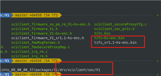

                  I'm not entirely sure the burn is ok because I'm running into a problem。
                 compiler sbl through make -s -j4 BOARD=j721e_evm CORE=mcu1_0 BUILD_PROFILE=release sbl_mmcsd_img_hlos_hs and copy to SD
                 Power on and start, sbl can start normally, but cannot load tifs.bin correctly
                 I tried the tifs*.bin under packages/ti/drv/sciclient/soc/V1, but it doesn't solve the problem
                 Generating the corresponding tifs*.bin through the script firmwareHeaderGen.sh also does not work
                I can't understand very well, what kind of tifs.bin is needed(dual signed or single signed)
                please give a reasonable solution,thanks a lot!
