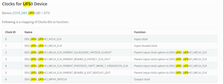

The J784S4 UFS Clock IDs are as below:
The j721e UFS clock IDs are as below:
There are differences w.r.t clock IDs. This is not enabled as part of the present SDK offering on J784s4.
I will check & get back to you on when this will be enabled.
Keerthy

I changed dts file and now log:
[ 3.499136] cdns-ufshcd 4e84000.ufs: ufshcd_populate_vreg: Unable to find vdd-hba-supply regulator, assuming enabled [ 3.509663] cdns-ufshcd 4e84000.ufs: ufshcd_populate_vreg: Unable to find vcc-supply regulator, assuming enabled [ 3.519830] cdns-ufshcd 4e84000.ufs: ufshcd_populate_vreg: Unable to find vccq-supply regulator, assuming enabled [ 3.530078] cdns-ufshcd 4e84000.ufs: ufshcd_populate_vreg: Unable to find vccq2-supply regulator, assuming enabled [ 3.541294] scsi host0: ufshcd [ 3.563309] cdns-ufshcd 4e84000.ufs: ufshcd_print_pwr_info:[RX, TX]: gear=[1, 1], lane[1, 1], pwr[SLOWAUTO_MODE, SLOWAUTO_MODE], rate = 0 [ 3.585950] davinci_mdio 46000f00.mdio: davinci mdio revision 9.7, bus freq 1000000 [ 3.595053] davinci_mdio 46000f00.mdio: phy[0]: device 46000f00.mdio:00, driver TI DP83867 [ 3.599505] cdns-ufshcd 4e84000.ufs: ufshcd_print_pwr_info:[RX, TX]: gear=[3, 3], lane[2, 2], pwr[FAST MODE, FAST MODE], rate = 2 [ 3.603414] am65-cpsw-nuss 46000000.ethernet: initializing am65 cpsw nuss version 0x6BA02102, cpsw version 0x6BA82102 Ports: 2 quirks:00000000 [ 3.615010] cdns-ufshcd 4e84000.ufs: ufshcd_find_max_sup_active_icc_level: Regulator capability was not set, actvIccLevel=0 [ 3.639091] scsi 0:0:0:49488: Well-known LUN TOSHIBA THGAF8G8T23BAILB 0300 PQ: 0 ANSI: 6 [ 3.648318] scsi 0:0:0:49476: Well-known LUN TOSHIBA THGAF8G8T23BAILB 0300 PQ: 0 ANSI: 6 [ 3.657438] cdns-ufshcd 4e84000.ufs: ufshcd_scsi_add_wlus: BOOT WLUN not found
