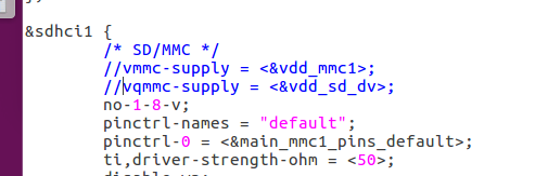

AM625 Custom board: SD card driver's initialization fails, cause could be SD card voltage is fixed to 3.3V. Need suggestions to change the software to fix SD card voltage to 3.3V for testing.
