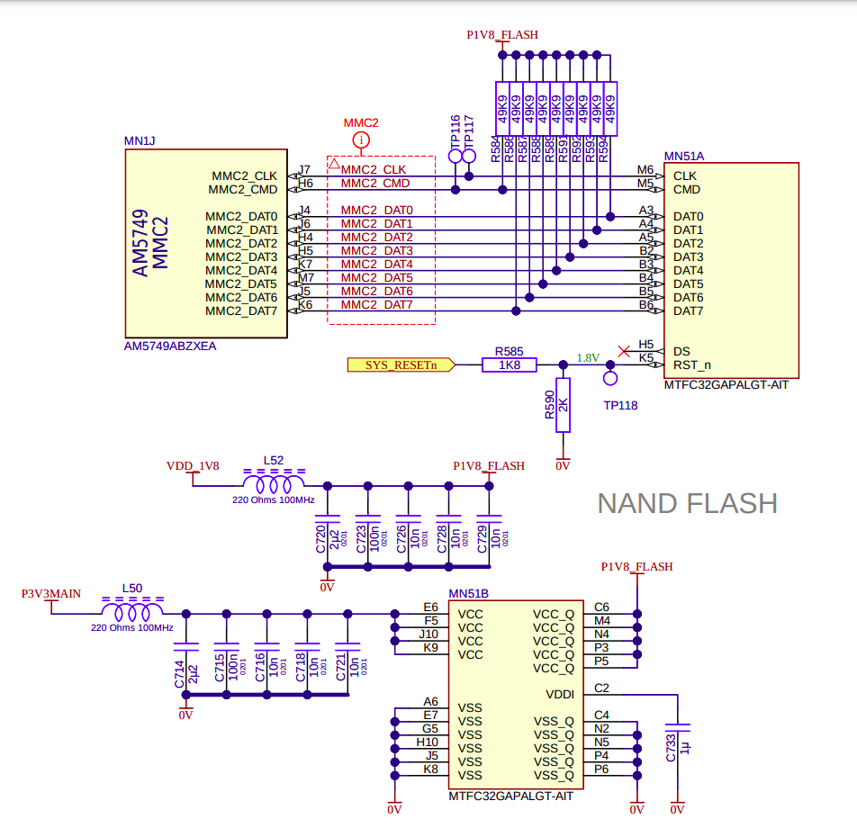

I have a custom board based on AM5749 Sitara processor. Everything works fine when booting from SD card. The problem occurs when eMMC is used as boot device (when SD card is not present). Sometimes the boot fails and I get this log on serial:

  • Hi David
    Card did not respond to voltage select! : -110
    its seems you card is not responding sometime.
    Can you provide more information like
    1.which sdk you are using
    2.Can you share the pass and fail condition logs ?
    3.Which emmc part no you are using ?
    4.Can you probe the signal and see if you are seeing any unusual behaviour in failing case
    5.Help share the schematic so that we can get it reviewed from the hw engineer
    6.Help share the register dumps as well in pass and fail case.
    Diwakar
  • Hi Diwakar, thanks for your reply.
    So I am not using an sdk but a linux distribution built with Yocto which integrates meta-ti on dunfell branch (cicd.2022.08.30.19.06.01)
    The eMMC that is currently used on the board is MTFC32GAPALGT-AIT (below you can find the schematics).
    /resized-image/__size/952x930/__key/communityserver-discussions-components-files/791/3833.emmc.png

    It is worth noting that when I try to boot from eMMC and it fails I don't have access to u-boot shell.
    I will look further into the signals to  see if anything abnormal appears in case of failure.
