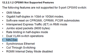

I have some questions about CPSW0 Ethernet Switch. Could you give me some advice?
Question1:
MACSec is not supported from TRM. So does it mean IEEE 802.1AE is not compliant?And we cannot achieve this function even if we use a Ethernet Phy with MACSec, is it right?
Question 2:
I would like to confirm if more other standards can be supported by CPSW0. Some are found in TRM, but the other aren't found. Pls help me note it if you can.
• IEEE 802.1AS_Found in TRM and compliant
• IEEE 802.1Qat (included in 802.1Q)_Found in TRM and compliant
• IEEE 802.1Qav (included in 802.1Q)_Found in TRM and compliant
• IEEE 802.1Qbv_Found in TRM and compliant
• IEEE 802.1Qbu_need to be checked
(Frame Preemption)
• IEEE 802.1CB_need to be checked
(Frame Replication & Elimination)
• IEEE 802.1Qci_need to be checked
(Central Configuration Method)
