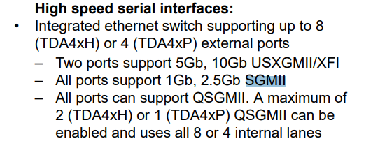

TDA4AH-Q1: 2 PHY's different clock one Serdes
Part Number: TDA4AH-Q1
Is it possible to use two SGMII PHYS simultaneously connected to a single SERDES say SERDES4, but those have different bit rates (say 1Gb/s and 100Mb./s or 1Gb/s and 2.5Gb/s). In other words, is it possible to communicate to both Phys at the same time or does that require changing the clock frequency?
