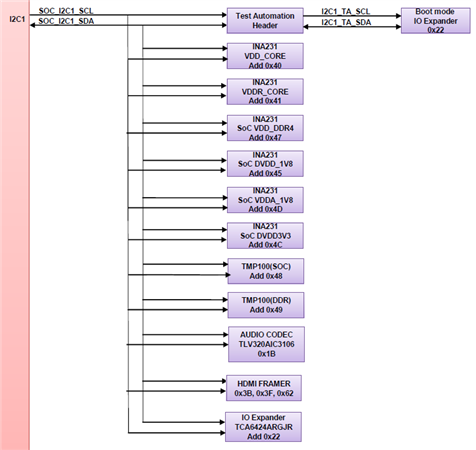

I am trying to communicate with I2C devices i.e., temperature sensors and LED Driver but when I run "I2Cdetect -l " I could not see both devices getting detected.
Could you please let me know what changes I need to do to access both devices.

    This is my understanding of why SoC_I2C1 is not showing temperature sensors at slave address set to 0x48 and 0x49.
    I am attaching here a segment of how SoC_I2C1 is defined in the device tree files.

    So the above declaration states that considering I2C1 bus, only three such slaves will be addressed/detected. They are 0x22, 0x3b and 0x1b
    And the rest we need to add if we want to probe them.
    As far as wakeup I2C0 is concerned I would suggest you to make the node enabled.
    This can be done by stating status to "okay"

  • I don't have any further comments on top of what Vaibhav has already said. In general, you need to tell Linux that something exists before you can expect to communicate with it.
