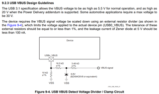

My customer reported USB issue on their custom boards. In their system, USB port0 is configured OTG and works as peripheral.
When the issue happens the USB cannot be detected on Host side.
The software is Linux SDK based.
The issue happens on four boards in 115 boards total. These boards were working fine before, but they found the issue recently.
The customer found USB+ signal level is too small (~0.4V) on failing boards.
Please see attached excel sheet for details. Do you have any idea why such issue happens?
