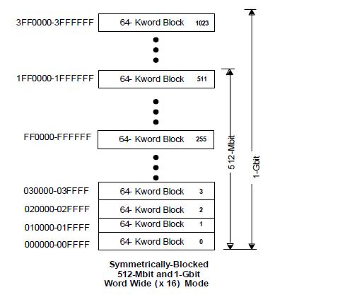

Would like to consult you on the NOR flash driver in armubl-03.20.00.11 used for OMPAL138.
The driver supports both 8-bit and 16-bit data bus width.
When it is used for word configurationn (16-bit data bus width) flash, the address argument in all the APIs is address to single byte or address to single word ?
I expect it to be address to single word in the case for word configuration flash.
rgds,
kc Wong
  • For example, I am using 1Gb (64M x 16) Flash - PC28F00AP30EF from Micron (Numonyx).
    So, the CFI query will set the below.
    busWidth = 2 (BUS_16BIT)
    flashSize (in bytes) = 128 MB
    blockSize (in bytes) = 128 KB (0x20000)
    numberBlocks = 1024
    numberRegions = 1
    With this, NOR_getBlockInfo will always return the blockSize = 0x20000. Let's pick example on erase operation in NOR_erase. In the code, it will step through the block with blockSize 0x20000. But the address in NOR flash refers to a word (as shown in below picture).
    addr = blockAddr + blockSize;
     So, what will happen is every alternate block will be skipped for erase because every block is 64 Kword (0x10000). Isn't it ?
    rgds,
    kc Wong
