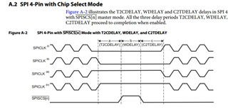

The delay of C2T and T2C can be understood as chip selection time and chip selection hold time, resulting in clock after time or clock end time delay.

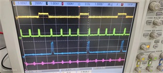

But my concern is why the WDELAY time in the timing chart is so large, as shown in the picture at 780ns.
In the DEMO program, SPI_SPIFMT.WDELAY does not have a time set, and the default value of the register is 0. And with the default value of 0 for SPI_SPIDAT_1 WDEL, why does the CS switching time for each frame of data take 780ns?
Now the core board circuit is fully encapsulated, not open to the public, and cannot be rectified. We directly introduce SPI data cables from the core board circuit for timing testing. Now I want to know why the hardware circuit is not executed according to the software settings?
Our project now requires an interruption time of 3.3us to complete multiple SPI controls, and this delay in project design cannot be accepted
Suspect that there is a delay when the CPU accesses the external device. Every time the transmission is retransmitted, there is a certain delay between the CPU and the external device. Is it due to internal limitations of the CPU.

  • Hi,Shankari G
    Thank you for your test results.
    The estimated time to read a data is 66000000/65535=1007ns.
    nor flash clk in the code is 25M, period 40ns? In theory, reading a byte (8bits) =(8+2)*40=400ns, why does the CPU take 1007ns?
    How long does it take? Is it a delay between bytes? In our tests, we found not only byte delay but also CS switching delay(780ns).
    Test Method When the NOR Flash continuous frame write address CMD=0x9f is simulated to write data, the oscilloscope waveform is read.

    In the instruction manual of C6678 IC:
    Eight TMS320C66xTm DSP Core Subsystems (C66x CorePacs), Each with – 1.0 GHz, 1.25 GHz, or 1.4 GHz C66x
    May I ask why the CPU frequency is not set to 1250MHz?
    In code testing:
    Device Speed Register (DEVSPEED)
    #define DEVSPEED (*(unsigned int *)0x026203F8u)
    Device speed grade = 1250MHz.
    Software code settings:
    DSP frequency to set 1250 MHZ
    Increasing the "SPI_MAX_FREQ            10000000"
     SPI  scalar = ((spi_iclk / freq) - 1 )& 0xFF;
    spi_iclk =10M,freq=gDSP_Core_Speed_Hz/6,
    unsigned int gDSP_Core_Speed_Hz=   1250000000;
    SPI PRESCALE= 19
    spiRegs->SPIFMT[0] = (8 << CSL_SPI_SPIFMT_CHARLEN_SHIFT) |
    (scalar << CSL_SPI_SPIFMT_PRESCALE_SHIFT)
    The SPI CLK under the oscilloscope changes to 8.3333MHz. SPI CLK did not approach 10MHz
    Xing

  • The delay between bytes (8 bits) is 690ns, and the delay for a data frame ( CS switching delay )is also about 690ns.

    Debugging conditions:
    when the DSP core runs at 1250 MHz.
    SPI module clk in the code is 25M, i.e, period ----> 40ns
    Final optimization test results:
    1、Total_cpu_cycle of [SPI Read of 65536 bytes ] = 49 156 122 cycles
    49156122 cycles      =      0.039  seconds  for 65536 bytes of SPI read.
             ======>    ( 1 / 1250000000 ) x 49156122  = 0.039 seconds.     ---- > 65536 bytes
             =====> 0.039 seconds for 524288 bits.
            =============> 0.039 / 524288 = 74 ns for 1 bit --- > practically
    2、Total_cpu_cycle of [ SPI Write of 65536 bytes ] = 945195395 cycles
    945195395 cycles      =     seconds  for 65536 bytes of SPI read.
    (I feel like there was a typo in this part. Should it be like this:
    945195395 cycles      =    0.75 seconds  for 65536 bytes of SPI write. )
             ======>    ( 1 / 1250 000 000 ) x 945 195 395 = 0.039 seconds.
    ( ( 1 / 1250 000 000 ) x 945 195 395 = 0.075 seconds. )
        =============> 0.075 / 524288 = 143 ns for 1 bit --- > practically(Should this be the case here?)

    The test results of C6678 platform show that the SPI transmission function is normal, but the transmission speed is not the theoretical calculation speed. According to the needs of the company project, I want to solve the problem of SPI transmission delay. Therefore, I hope TI technology can provide some solutions or continue to analyze the problem, and we will find ways to solve the problem after the specific positioning of the problem.
    According to the above test results:
    N25Q128A21BSF40F ic instruction manual Read Data Bytes (READ)(SPI_NOR_CMD_READ) timing:
    According to the figure above, there is no CS switch when DSP continuously sends data. The reason why 75ns sends 1 bit is probably due to the delay between every 8 bits of data, which is confirmed by the SPI timing waveform in the picture of the chat record above.
    In theory, there is a delay between each byte: 75-40=35ns,35*8=280ns
    In spi_claim() SPIFMT[0].wdelay is not set and should be the register default of 0, so there should be no delay between bytes.
    Now if the DSP operates at 1GHZ and the SPI peripheral works at 1/6 frequency division, the two operating frequencies are not the same. To ensure synchronization, SPI_SPIBUF.TXFULL and SPI_SPIBUF.RXEMPTY bits are added to the spi_xfer () function to wait for judgment bits before SPI data is read and written. Is that the mechanism?
