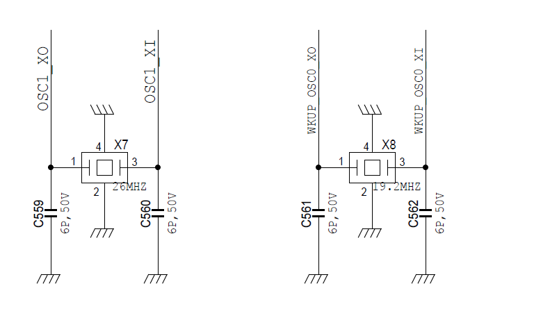

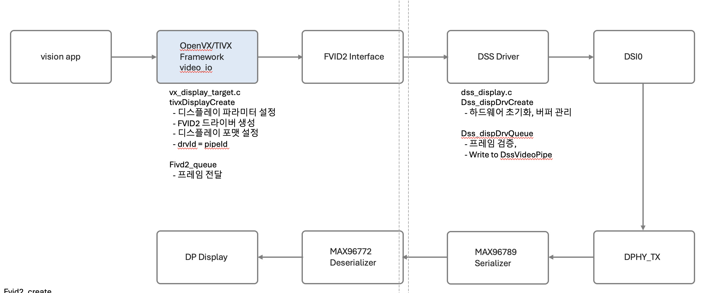

My customer is trying to connect MAX96789 to DSS port 0 through DSI, but there is no display through MAX96789.
Could you please check if below setting are OK to display?

Their clock sources are OSC0 = 19.2M, OSC1 = 26M as below.
