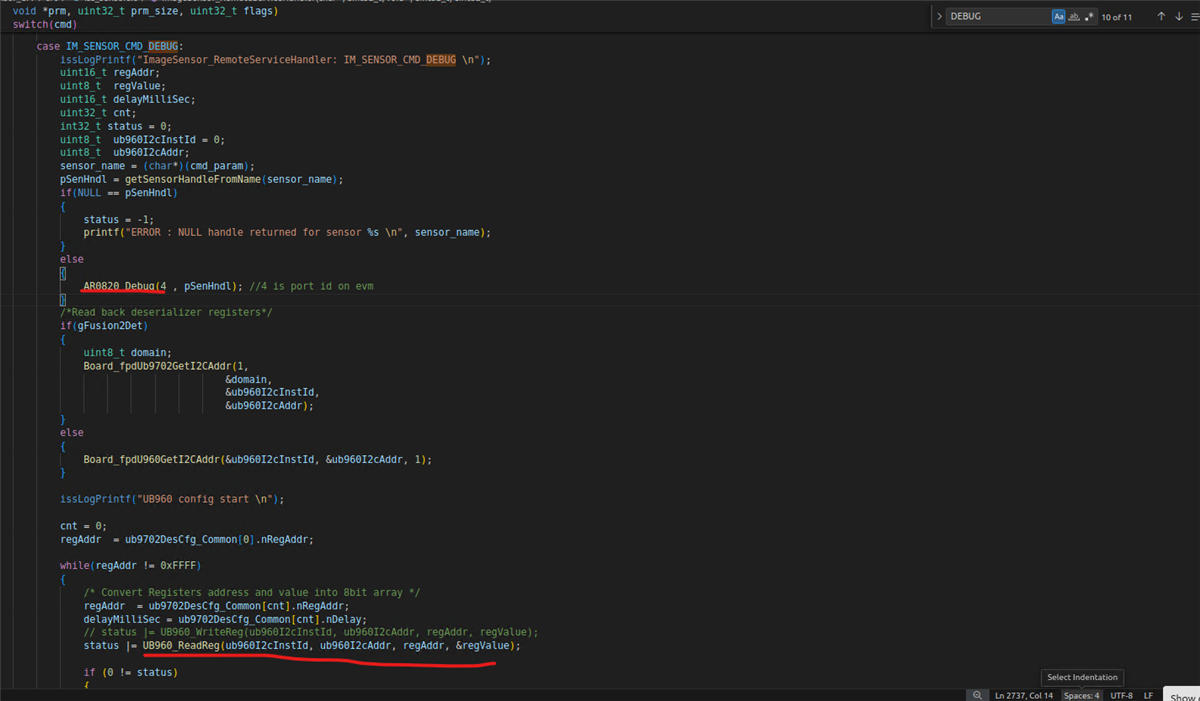

Env: QNX + SDK Version: 9_2_0_5
Issue: The leopard AR0280 is not working with Fusion Board2 but it is working with Fusion Board 1.
To debug the issue I am using single cam app. The output image looks as below:
The bigger monitor is the Leopard AR0820 camera output and the smaller one is ONSEMI AR0280.
After the single cam graph is running, I am sending the IM_SENSOR_CMD_DEBUG to remote service handler in imaging->iss_sensor.c.
In the handler I am reading back the sensor registers and fusion board 2 des registers(snap attached).

I have verified the values with datasheets and readback values with fusion board 1 and not able to figure out where the issue is. Kindly Suggest.
