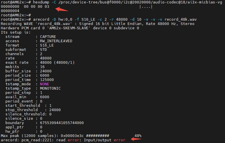

I have a development environment for am6234, with our own evaluation board.
The software SDK version is PROCESSOR-SDK-LINUX-RT-AM62X-10.01.10.04.
The model of the audio codec chip is TLV320AIC3101IRHBT.
Set the codec chip as follows:

After performing the recording operation below, the recording cannot be performed normally and the error message above appears:
root@AM62x:~# arecord -D hw:0,0 -f S16_LE -c 2 -r 48000 -d 10 -v -v -v record_48k.wav
Recording WAVE 'record_48k.wav' : Signed 16 bit Little Endian, Rate 48000 Hz, Stereo
Hardware PCM card 0 'AM62x-SKEVM-SLAVE' device 0 subdevice 0
Its setup is:
  stream       : CAPTURE
  access       : RW_INTERLEAVED
  format       : S16_LE
  subformat    : STD
  channels     : 2
  rate         : 48000
  exact rate   : 48000 (48000/1)
  msbits       : 16
  buffer_size  : 24000
  period_size  : 6000
  period_time  : 125000
  tstamp_mode  : NONE
  tstamp_type  : MONOTONIC
  period_step  : 1
  avail_min    : 6000
  period_event : 0
  start_threshold  : 1
  stop_threshold   : 24000
  silence_threshold: 0
  silence_size : 0
  boundary     : 6755399441055744000
  appl_ptr     : 0
  hw_ptr       : 0
Max peak (12000 samples): 0x00008000 #################### 100%
arecord: pcm_read:2221: read error: Input/output error
But when the sampling rate is set to 44100, recording can be done and I didn't see the error above:

It can be observed that the recorded audio has been accelerated.

root@AM62x:~# cat /sys/kernel/debug/clk/clk_summary | grep tlv320_mclk
 tlv320_mclk                         0       0        0        12288000    0          0     50000      Y   simple-audio-card,codec         no_connection_id

root@AM62x:~#
root@AM62x:~#
root@AM62x:~#
root@AM62x:~# ll /proc/asound
total 0
lrwxrwxrwx 1 root root 5 10月 22 04:04 AM62xSKEVMSLAVE -> card0
dr-xr-xr-x 5 root root 0 10月 22 04:04 card0
-r--r--r-- 1 root root 0 10月 22 04:04 cards
-r--r--r-- 1 root root 0 10月 22 04:04 devices
-r--r--r-- 1 root root 0 10月 22 04:04 pcm
-r--r--r-- 1 root root 0 10月 22 04:04 timers
-r--r--r-- 1 root root 0 10月 22 04:04 version
root@AM62x:~#
root@AM62x:~# cat /proc/asound/version
Advanced Linux Sound Architecture Driver Version k6.6.58-rt45.
root@AM62x:~#
root@AM62x:~# cat /proc/asound/cards
 0 [AM62xSKEVMSLAVE]: simple-card - AM62x-SKEVM-SLAVE
                      AM62x-SKEVM-SLAVE
root@AM62x:~#
root@AM62x:~# cat /proc/asound/devices
  2: [ 0- 0]: digital audio playback
  3: [ 0- 0]: digital audio capture
  4: [ 0]   : control
 33:        : timer
root@AM62x:~#
root@AM62x:~# cat /proc/asound/pcm
00-00: 2b10000.audio-controller-tlv320aic3x-hifi tlv320aic3x-hifi-0 : 2b10000.audio-controller-tlv320aic3x-hifi tlv320aic3x-hifi-0 : playback 1 : capture 1
root@AM62x:~#
root@AM62x:~# cat /proc/asound/timers
G0: system timer : 1000.000us (10000000 ticks)
P0-0-0: PCM playback 0-0-0 : SLAVE
P0-0-1: PCM capture 0-0-1 : SLAVE
root@AM62x:~#
root@AM62x:~# ll /proc/asound/card0/
total 0
-r--r--r-- 1 root root 0 10月 22 04:04 id
dr-xr-xr-x 4 root root 0 10月 22 04:04 pcm0c
dr-xr-xr-x 4 root root 0 10月 22 04:04 pcm0p
root@AM62x:~#
root@AM62x:~# ll /proc/asound/card0/pcm0c
total 0
-r--r--r-- 1 root root 0 10月 22 04:04 info
dr-xr-xr-x 8 root root 0 10月 22 04:04 sub0
root@AM62x:~#
root@AM62x:~# ll /proc/asound/card0/pcm0c/sub0/
total 0
-r--r--r-- 1 root root 0 10月 22 04:04 hw_params
-rw-r--r-- 1 root root 0 10月 22 04:04 prealloc
-r--r--r-- 1 root root 0 10月 22 04:04 prealloc_max
-r--r--r-- 1 root root 0 10月 22 04:04 status
-r--r--r-- 1 root root 0 10月 22 04:04 sw_params
root@AM62x:~#
root@AM62x:~# ll /proc/asound/card0/pcm0p
total 0
root@AM62x:~#
root@AM62x:~# ll /proc/asound/card0/pcm0p/sub0/
total 0
root@AM62x:~#
root@AM62x:~# cat /proc/asound/card0/id
AM62xSKEVMSLAVE
root@AM62x:~#
root@AM62x:~# cat /proc/asound/card0/pcm0c/info
card: 0
device: 0
subdevice: 0
stream: CAPTURE
id: 2b10000.audio-controller-tlv320aic3x-hifi tlv320aic3x-hifi-0
name: 2b10000.audio-controller-tlv320aic3x-hifi tlv320aic3x-hifi-0
subname: subdevice #0
class: 0
subclass: 0
subdevices_count: 1
subdevices_avail: 1
root@AM62x:~#
root@AM62x:~# cat /proc/asound/card0/pcm0c/sub0/status
closed
root@AM62x:~#
root@AM62x:~# cat /proc/asound/card0/pcm0c/sub0/prealloc
512
root@AM62x:~#
root@AM62x:~# cat /proc/asound/card0/pcm0c/sub0/prealloc_max
18014398509481983
root@AM62x:~#
root@AM62x:~# cat /proc/asound/card0/pcm0c/sub0/hw_params
closed
root@AM62x:~#
root@AM62x:~# cat /proc/asound/card0/pcm0c/sub0/sw_params
closed
root@AM62x:~#
root@AM62x:~# cat /proc/asound/card0/pcm0p/info
card: 0
device: 0
subdevice: 0
stream: PLAYBACK
class: 0
subclass: 0
subdevices_count: 1
subdevices_avail: 1
root@AM62x:~#
root@AM62x:~# cat /proc/asound/card0/pcm0p/sub0/status
closed
root@AM62x:~#
root@AM62x:~# cat /proc/asound/card0/pcm0p/sub0/prealloc
512
root@AM62x:~#
root@AM62x:~# cat /proc/asound/card0/pcm0p/sub0/prealloc_max
18014398509481983
root@AM62x:~#
root@AM62x:~# cat /proc/asound/card0/pcm0p/sub0/hw_params
closed
root@AM62x:~#
root@AM62x:~# cat /proc/asound/card0/pcm0p/sub0/sw_params
closed
root@AM62x:~#
root@AM62x:~# ll /sys/kernel/debug/asoc/
total 0
drwxr-xr-x 6 root root 0 10月 22 04:02 AM62x-SKEVM-SLAVE
-r--r--r-- 1 root root 0  1月  1  1970 components
-r--r--r-- 1 root root 0  1月  1  1970 dais
root@AM62x:~#
root@AM62x:~# cat /sys/kernel/debug/asoc/dais
tlv320aic3x-hifi
snd-soc-dummy-dai
root@AM62x:~#
root@AM62x:~# cat /sys/kernel/debug/asoc/components
tlv320aic3x.2-0018
snd-soc-dummy
snd-soc-dummy
root@AM62x:~#
root@AM62x:~# ll /sys/kernel/debug/asoc/AM62x-SKEVM-SLAVE
total 0
drwxr-xr-x 3 root root 0 10月 22 04:02 2b10000.audio-controller
drwxr-xr-x 2 root root 0 10月 22 04:02 dapm
-rw-r--r-- 1 root root 0 10月 22 04:02 dapm_pop_time
drwxr-xr-x 3 root root 0 10月 22 04:02 dma:2b10000.audio-controller
drwxr-xr-x 3 root root 0 10月 22 04:02 tlv320aic3x.2-0018
root@AM62x:~#
root@AM62x:~# ll /sys/kernel/debug/asoc/AM62x-SKEVM-SLAVE/2b10000.mcasp
ls: cannot access '/sys/kernel/debug/asoc/AM62x-SKEVM-SLAVE/2b10000.mcasp': No such file or directory
root@AM62x:~#
root@AM62x:~#
root@AM62x:~#
root@AM62x:~#
root@AM62x:~# ll /sys/kernel/debug/asoc/AM62x-SKEVM-SLAVE/2b10000.audio-controller
total 0
root@AM62x:~#
root@AM62x:~# ll /sys/kernel/debug/asoc/AM62x-SKEVM-SLAVE/2b10000.audio-controller/dapm/
total 0
-r--r--r-- 1 root root 0 10月 22 04:02  bias_level
-r--r--r-- 1 root root 0 10月 22 04:02 'IIS Capture'
-r--r--r-- 1 root root 0 10月 22 04:02 'IIS Playback'
root@AM62x:~#
root@AM62x:~# ll /sys/kernel/debug/asoc/AM62x-SKEVM-SLAVE/dapm
total 0
-r--r--r-- 1 root root 0 10月 22 04:02 'Headphone Jack'
-r--r--r-- 1 root root 0 10月 22 04:02 'Microphone Jack'
root@AM62x:~#
root@AM62x:~# ll /sys/kernel/debug/asoc/AM62x-SKEVM-SLAVE/dma:2b10000.audio-controller
total 0
root@AM62x:~#
root@AM62x:~#
root@AM62x:~#
root@AM62x:~# ll /sys/kernel/debug/asoc/AM62x-SKEVM-SLAVE/dma:2b10000.audio-controller/dapm
'/sys/kernel/debug/asoc/AM62x-SKEVM-SLAVE/dma:2b10000.audio-controller/dapm':
total 0
total 0
root@AM62x:~#
root@AM62x:~# ll /sys/kernel/debug/asoc/AM62x-SKEVM-SLAVE/tlv320aic3x.2-0018
total 0
root@AM62x:~# ll /sys/kernel/debug/asoc/AM62x-SKEVM-SLAVE/tlv320aic3x.2-0018/dapm/
total 0
-r--r--r-- 1 root root 0 10月 22 04:02  Capture
-r--r--r-- 1 root root 0 10月 22 04:02  Detection
-r--r--r-- 1 root root 0 10月 22 04:02 'DMic Rate 128'
-r--r--r-- 1 root root 0 10月 22 04:02 'DMic Rate 32'
-r--r--r-- 1 root root 0 10月 22 04:02 'DMic Rate 64'
-r--r--r-- 1 root root 0 10月 22 04:02 'GPIO1 dmic modclk'
-r--r--r-- 1 root root 0 10月 22 04:02  HPLCOM
-r--r--r-- 1 root root 0 10月 22 04:02  HPLOUT
-r--r--r-- 1 root root 0 10月 22 04:02  HPRCOM
-r--r--r-- 1 root root 0 10月 22 04:02  HPROUT
-r--r--r-- 1 root root 0 10月 22 04:02 'Left ADC'

But,when we use the SDK PROCESS SDK-LINUX-RT-AM62X-08.06.00.42, it can perform recording operations normally without any errors.
The recorded audio file is as follows:
May I ask how to solve this problem?

  • Hi Li,
    Does changing the mic bias voltage make any difference?
    Suren
  • Hi Suren,
    Modifying the value of mic bias voltage, the result is still the same, but there are still errors. The test results are as follows:
    Li
  • Hi Li,
    You mentioned that on SDK 8.6 the audio can be recorded correctly on 44.1KHz and 48Khz as well?
    Are you sure your BCLK and WCLK/Frame Sync is correctly configured?
    The only changes that have gone in post 8.6 are the latency improvements in audio.
    Same configuration can't work on 10.1 released SDK code, is my understanding correct?
    Suren
  • Hi Suren,
    Yes, on SDK 8.6, audio can be recorded correctly at 44.1KHz and 48Khz.
    It can be confirmed that the BCLK and WCLK/frame synchronization configurations are correct.
    As you understand, the same configuration does not work on the SDK 10.1.
    Li

    [2025-02-10 22:03:33.139] Recording WAVE 'test.wav' : Signed 16 bit Little Endian, Rate 44100 Hz, Stereo
    root@am62xx-evm:~# aplay -D hw:0,0 test.wav  -f S16_LE test.wav -d 10
    [2025-02-10 22:03:49.410] Playing WAVE 'test.wav' : Signed 16 bit Little Endian, Rate 44100 Hz, Stereo
    [2025-02-10 22:03:59.473] root@am62xx-evm:~# aplay -D hw:0,0 test.wav
    [2025-02-10 22:04:04.417] Playing WAVE 'test.wav' : Signed 16 bit Little Endian, Rate 44100 Hz, Stereo
    root@am62xx-evm:~# arecord -D hw:0,0 -r 44100 -c 2 -f S16_LE test.wav -d 10
    [2025-02-10 22:04:20.800] Recording WAVE 'test.wav' : Signed 16 bit Little Endian, Rate 44100 Hz, Stereo
    [2025-02-10 22:04:34.159] Playing WAVE 'test.wav' : Signed 16 bit Little Endian, Rate 44100 Hz, Stereo
    [2025-02-10 22:04:44.238] root@am62xx-evm:~#
    also we have disabled the fifo on our SDK software post 9.2 release. Refer the DTS file:
    git.ti.com/.../k3-am62x-sk-common.dtsi
    See if this helps.
    Suren
  • Hi Suren,
    Thank you for your patient support. The audio module can now record and play audio normally.
    Li
