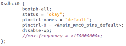

The customer tested the EMMC interface at 200MHz and found that no data was sent out.
However, when the signal is set to 150MHz, the communication is normal.
1.Under this setting (150M), the hardware is measured OK, and using stressapptest, it is passed
If the following settings are used (we assume the default is 200M), the hardware cannot measure data and the stressapptest test fails.
