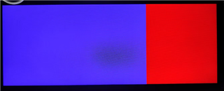

I'm using this Gstreamer command to split one viedo streram into two, but there's an issue, the color of two output is error.
Actually the color in the left section are correct, the table should be yellow, but the right section is blue.
Here is the command

And here is the pipeline.

I also try videotestsrc output a blue screen,but also got a wrong color in sink_1.

I testd this command on a machine without the updated GStreamer plugin, and it works fine.

  • Hi Jason,
    Thank you for reporting this. I've reproduced it on my side using videotestsrc. Let me look into this and get back to you as soon as possible.

  • Hi Jason,
    We're still investigating and trying to figure out the root cause. In my testing, I found that the issue may be related to the aspect ratio of the second downscaled image. For example, the following pipeline can run without any issue:
