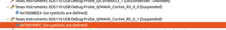

  • Hi Meet,
    Thank you for your support.
    Here is a result of No.2 from our customer.
    We reproduced the symptom again with only the Cortex-A53 running,
    and took a screenshot of the CCS debug screen showing the hung state.
    I would appreciate it if you could share your views on the above result and the progress on other matters.
    Meet said;
    1. Can we ask the customer to boot any dummy images like this to R5F0-0 and R50-1 for now, to unblock them for further development?
    In addition, although our customer understands the above request,
    I have not asked them to do so in order to allow them to focus on debugging.
    Thank you for your understanding.
    Kanae
  • Hi Kanae,
    Thanks for sharing this, This does show the SP for R5F0-1 accessing the restricted memory, which can cause the exception. But I am not able to reproduce this on my EVM, even if the R5F0-1 is not loaded it is supposed to be in WFI state, which is what I observe at my end:
    Was there any change done to the default self reset sequence(Bootloader_socCpuResetReleaseSelf) in customer's setup?

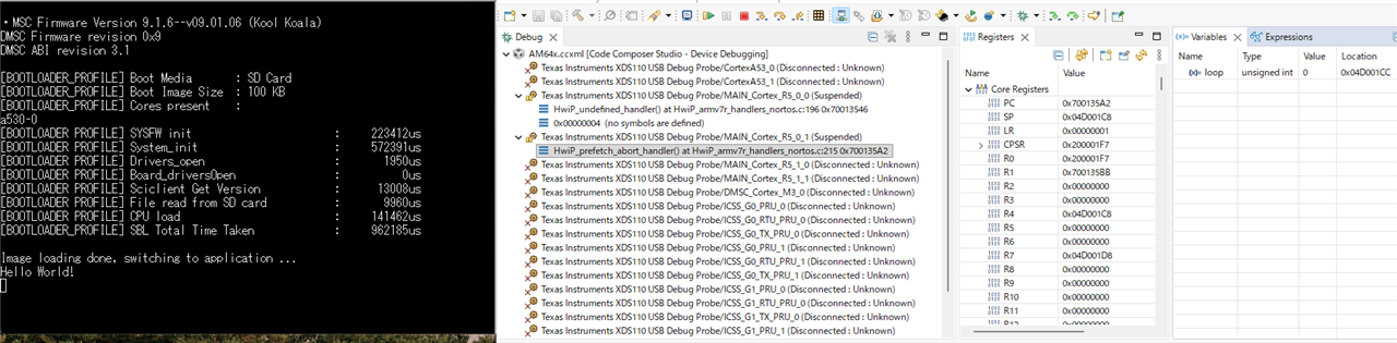

    Here are data from our customer regarding the following item for confirmation.
    Meet said:
    3. Is there any update on their testing to try to reproduce this issue on EVM?
    We ran the sample program on EVM (Rev.C) and confirmed the exception on both R5F0-0 and R5F0-1 cores.
    The sample program used for verification was built in the following environment:
    We made no changes whatsoever to the imported source code.
    CCS: 12.5.0
    SysConfig: 1.18.0
    MCU+ SDK for AM64x: 9.1.0.41
    SBL: The following sample program within the SDK: import
             \mcu_plus_sdk_am64x_09_01_00_41\examples\drivers\boot\sbl_sd\am64x-evm\r5fss0-0_nortos\ti-arm-clang
    Application: Import the following sample program from the SDK:
             \mcu_plus_sdk_am64x_09_01_00_41\examples\hello_world\am64x-evm\a53ss0-0_freertos\gcc-aarch64
    After building, rename the output file “hello_world_am64x-evm_a53ss0-0_freertos_gcc-aarch64.appimage.hs_fs”
    to ‘app’. Save the “tiboot3.bin” and " Save the “app” file to the SD card, verify operation via SD card boot,
    and confirm that after outputting “Hello World!”, exception handling occurs on both R5F0-0 and R5F0-1 as shown in the image below.
    I will also share the “tiboot3.bin” and “app” files.
