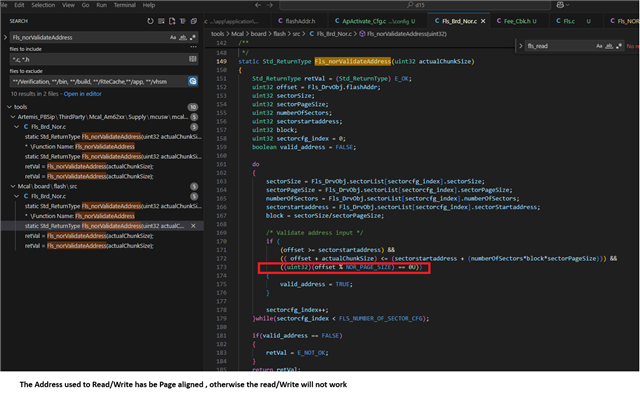

Hello Team,
1) The Fls_Read from mcal_am275x_11_01_00_03 Driver is expecting the source address to be Page aligned.
Our application read requests are not always page aligned, due to which the Fls_Read requests are failing.
2) In case the entire flash is to be used, the below condition will fail as the end and nor_size are equal
Please provide the required solution for the issues
