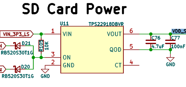

I am currently debugging a latest SIP OSD62x-PM which uses the AM625 processor. I am facing an issue with the SD card power rail (VDD_SD).
When the SD card is not connected, I measure VDD_SD at 3.3V. However, when I insert an SD card into the slot, the voltage drops to 1.8V.
During testing, I verified that the VLDO1 output from the PMIC is stable at 3.3V, but the output of U11 (TPS22918DBVR), which is providing VDD_SD, drops to 1.8V after the SD card is inserted.
Could you please help me understand the possible cause of this behavior?
 For the reference I had shared the schematic over chat.
