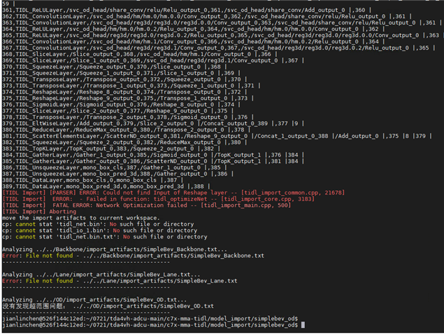

We are using tidl to export the model, but the model export failed, the log is as follows.
The TIDL version is 11.01.04.01.
The compressed file named E2E.zip, which contains the model and export config, has been uploaded to tidrive.ext.ti.com/.../100ec4b5-b2a9-4e4b-9208-f38f41488a4b

  • hello hongyao,
    I am able to reproduce your issue:
    [TIDL Import] [PARSER] ERROR: Could not find Input of Reshape layer, output name:/TopK_output_1, input name:/TopK_output_1_20_21 -- [tidl_import_common.cpp, 21649]
    [TIDL Import]  ERROR:  - Failed in function: tidl_optimizeNet -- [tidl_import_core.cpp, 3183]
    [TIDL Import]  FATAL ERROR: Network Optimization failed -- [tidl_import_main.cpp, 500]
    [TIDL Import] Aborting
    This reshape layer is likely to be introduced to link the second graph, which seems to be caused by some unsupported layers.
    The reducedmax and transpose is not supported
    and causes this issue when creating the second graph.
    I am able to import this model with the following modifications on your model. I deleted some nodes after sigmod and added outputs.
    To conclude, this should be an issue that TIDL does not parse the model correctly, however, you can work on with a work around that put some of the nodes to post-processing.
    Adam

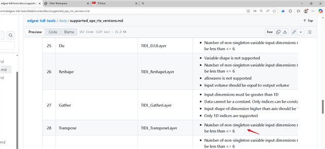

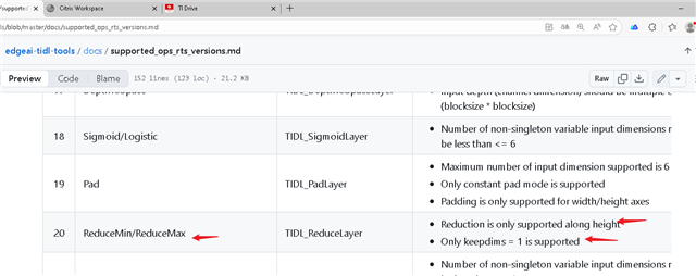

  • Hello Adam,
    As shown in the figure below,  The reducedmax and transpose is supported. Is there a problem or something?
    github.com/.../supported_ops_rts_versions.md
    Thanks.

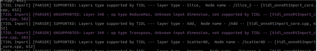

  • Hi Hongyao,
    This is a bug that the order of operators are not correctly parsed if reducemax goes after transpose.
    I am able to reproduce your issue with this simplified model:

    [TIDL Import] [PARSER] WARNING: Network not identified as Object Detection network : (1) Ignore if network is not Object Detection network (2) If network is Object Detection network, please specify "model_type":"OD" as part of OSRT compilation options
    [TIDL Import] [PARSER] SUPPORTED: Layers type supported by TIDL --- layer type - Sigmoid,  Node name - /hidden/Sigmoid -- [tidl_onnxRtImport_core.cpp, 652]
    [TIDL Import] [PARSER] UNSUPPORTED: Layer 1 - op type ReduceMax, Unknown input dimension, not supported by TIDL -- [tidl_onnxRtImport_core.cpp, 582]
    [TIDL Import] [PARSER] UNSUPPORTED: Layer 2 - op type Transpose, Unknown input dimension, not supported by TIDL -- [tidl_onnxRtImport_core.cpp, 582]

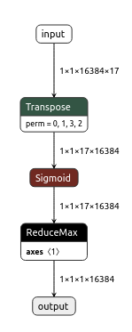

  • Hi Hongyao,
    And I also work out a workaround by change the operator order sigmod->transpose->reducemax to transpose->sigmod->reducemax. Could you help try this and modify your post processing accordingly?
    https://e2e.ti.com/cfs-file/__key/communityserver-discussions-components-files/791/transpose_5F00_sigmod_5F00_reducemax_5F00_model_5F00_16384_5F00_17_5F00_opset18.onnx

    Compute on node : TIDLExecutionProvider_TIDL_0_0
      0,       Transpose, 1, 1, input, /Transpose_output_0
      1,         Sigmoid, 1, 1, /Transpose_output_0, /hidden/Sigmoid_output_0
      2,       ReduceMax, 2, 1, /hidden/Sigmoid_output_0, output
    Input tensor name -  input
    Output tensor name - output
    In TIDL_onnxRtImportInit subgraph_name=subgraph_0
