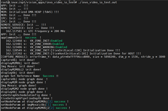

 However, when running the application,  it was found that the vxVerifyGraph interface was stuck, and there are no error logs.
Before running the application, I first run "source ./vision_apps_init.sh", and there were the following errors.
Could you please help me check if there are any problems or omissions in my modifications?
Thank you!

  • Hi Cheng,
    The supported combination of vp and dpi output is listed below,
    static const Fvid2_GraphEdgeInfo gDctrlGraphEdgeInfoDefaults[DSS_DCTRL_MAX_EDGES] =
        {DSS_DCTRL_NODE_VID1,     DSS_DCTRL_NODE_OVERLAY1},
        {DSS_DCTRL_NODE_VIDL1,    DSS_DCTRL_NODE_OVERLAY1},
        {DSS_DCTRL_NODE_VID2,     DSS_DCTRL_NODE_OVERLAY1},
        {DSS_DCTRL_NODE_VIDL2,    DSS_DCTRL_NODE_OVERLAY1},
        {DSS_DCTRL_NODE_VID1,     DSS_DCTRL_NODE_OVERLAY2},
        {DSS_DCTRL_NODE_VIDL1,    DSS_DCTRL_NODE_OVERLAY2},
        {DSS_DCTRL_NODE_VID2,     DSS_DCTRL_NODE_OVERLAY2},
        {DSS_DCTRL_NODE_VIDL2,    DSS_DCTRL_NODE_OVERLAY2},
        {DSS_DCTRL_NODE_VID1,     DSS_DCTRL_NODE_OVERLAY3},
        {DSS_DCTRL_NODE_VIDL1,    DSS_DCTRL_NODE_OVERLAY3},
        {DSS_DCTRL_NODE_VID2,     DSS_DCTRL_NODE_OVERLAY3},
        {DSS_DCTRL_NODE_VIDL2,    DSS_DCTRL_NODE_OVERLAY3},
        {DSS_DCTRL_NODE_VID1,     DSS_DCTRL_NODE_OVERLAY4},
        {DSS_DCTRL_NODE_VIDL1,    DSS_DCTRL_NODE_OVERLAY4},
        {DSS_DCTRL_NODE_VID2,     DSS_DCTRL_NODE_OVERLAY4},
        {DSS_DCTRL_NODE_VIDL2,    DSS_DCTRL_NODE_OVERLAY4},
        {DSS_DCTRL_NODE_OVERLAY1, DSS_DCTRL_NODE_VP1},
        {DSS_DCTRL_NODE_OVERLAY2, DSS_DCTRL_NODE_VP2},
        {DSS_DCTRL_NODE_OVERLAY3, DSS_DCTRL_NODE_VP3},
        {DSS_DCTRL_NODE_OVERLAY4, DSS_DCTRL_NODE_VP4},
        {DSS_DCTRL_NODE_VP1,      DSS_DCTRL_NODE_EDP_DPI0},
        {DSS_DCTRL_NODE_VP1,      DSS_DCTRL_NODE_DISCSYNC0},
        {DSS_DCTRL_NODE_VP1,      DSS_DCTRL_NODE_DISCSYNC1},
        {DSS_DCTRL_NODE_VP2,      DSS_DCTRL_NODE_DPI_DPI0},
        {DSS_DCTRL_NODE_VP2,      DSS_DCTRL_NODE_DPI_DPI1},
        {DSS_DCTRL_NODE_VP2,      DSS_DCTRL_NODE_EDP_DPI1},
        {DSS_DCTRL_NODE_VP3,      DSS_DCTRL_NODE_DSI_DPI2},
        {DSS_DCTRL_NODE_VP3,      DSS_DCTRL_NODE_EDP_DPI2},
        {DSS_DCTRL_NODE_VP3,      DSS_DCTRL_NODE_DISCSYNC0},
        {DSS_DCTRL_NODE_VP4,      DSS_DCTRL_NODE_DPI_DPI0},
        {DSS_DCTRL_NODE_VP4,      DSS_DCTRL_NODE_DPI_DPI1},
        {DSS_DCTRL_NODE_VP4,      DSS_DCTRL_NODE_EDP_DPI3},
        {DSS_DCTRL_NODE_VIDL2,    DSS_DCTRL_NODE_WB},
        {DSS_DCTRL_NODE_OVERLAY1, DSS_DCTRL_NODE_WB},
        {DSS_DCTRL_NODE_OVERLAY2, DSS_DCTRL_NODE_WB},
        {DSS_DCTRL_NODE_OVERLAY3, DSS_DCTRL_NODE_WB},
        {DSS_DCTRL_NODE_OVERLAY4, DSS_DCTRL_NODE_WB}
    So VP_1 cannot be used with DPI1. Use VP_4 with DPI1 and  VP_2  with DPI0.

  • Hi Gokul,
    The DisplayM2M node also uses VP_4.
    Does this mean that the DisplayM2M node cannot be used? Or is it possible that the DisplayM2M node can use other VP?
    Thank you!
  • Hi Cheng,
    If you require two DPI outputs and both for outputting BT601 format, then yes, display m2m cannot be used..
    Brijesh
  • Hi Brijesh and Gokul,
    Based on the above suggestion, I have made the following additional modifications.

    In the graph I created, when the "pipeId" parameter of the display node is set to defalut value of 2 (VP2), the image data can be successfully transmitted.
