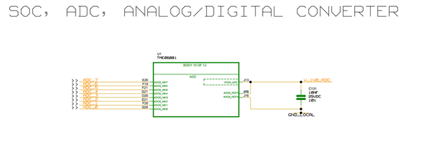

We have dseigned a custom board based on AM6442 where we are using 8 channel ADC's. Here we have observed few things as below
  • When there is no input voltage supplied and the pin is left floating we see a reading 0.3-0.4V
  • When the voltage is supplied above 1.7V to 1.8V we see the reading going only upto 1.7V only.
Please confirm whether this is expected behaviour from AM6442 or not?

    2. Voltage reading only up to ~1.7V: This is not expected behavior if your setup is configured correctly. The ADC measures the input by comparing it to its reference span, from VREFN (low) and VREFP (full-scale). The ADC should be able to measure the full-scale up to VREFP if the reference pins and input are supplied correctly. To help diagnose this, could you please provide:
    • A schematic showing your ADC input circuitry and signal source
    • The actual voltages present on VREFP and VREFN Pins
    • What voltage you're measuring relative to VREFP when the 1.7V limiting occurs
    Karam

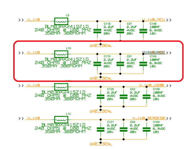

    Please find attached the screenshots addressing the points you mentioned:
    Regarding the actual voltages present on the VREFP and VREFN pins, they could not be measured directly.
    As the input approaches 1.8 V, the ADC reading saturates around 1.66 V to 1.7 V.
    Note:
    Please note that the 1.8 V power supply is sourced from the PMIC, part number TPS6522053RHBR.
    Thanks.
  • Hi Anjana,
    Thank you for your response. The schematic seems to mainly cover power, could you also please provide the schematic for the input circuitry/signal source?
