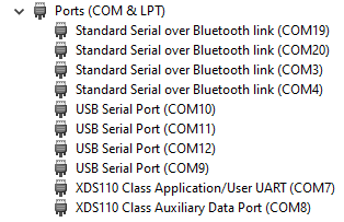

My COM ports after the setup is as shown below:

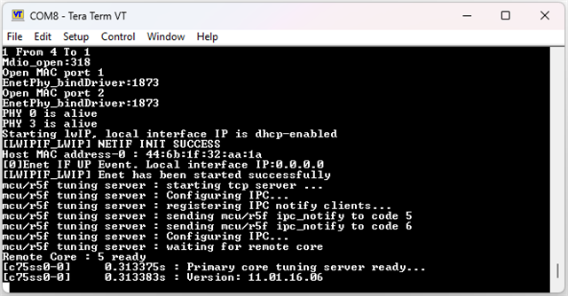

mcu/r5f tuning server : Configuring Codec...
[c75ss0-0]     0.000822s : asdk_flash_init done
[c75ss0-0]     0.000843s : asdk_flash_write: , 0ffset = 0x1a00000, nDWordsToWrite = 5
[c75ss0-0]     0.000856s : asdk_flash_write: , 0ffset = 0x1a00040, nDWordsToWrite = 1
[c75ss0-0]     0.000868s : asdk_flash_write: , 0ffset = 0x1a00044, nDWordsToWrite = 1
[c75ss0-0]     0.000880s : asdk_flash_write: , 0ffset = 0x1a00048, nDWordsToWrite = 1
[c75ss0-0]     0.000892s : asdk_flash_write: , 0ffset = 0x1a0004c, nDWordsToWrite = 1
[c75ss0-0]     0.000903s : asdk_flash_write: , 0ffset = 0x1a00050, nDWordsToWrite = 1
[c75ss0-0]     0.000915s : asdk_flash_write: , 0ffset = 0x1a00054, nDWordsToWrite = 1
[c75ss0-0]     0.001979s : Registering for ipc_notify ..
[c75ss0-0]     0.001992s : Sending IpcNotify_sendMsg to core 1
[c75ss0-0]     0.002005s : Waiting for MCU/R5F...
mcu/r5f tuning server : Configuring Codec...Done
Enabling clocks!
start to open driver.
EEPROM 0 MAC addr: Unable to read from eeprom instance number 1
EEPROM 1 MAC addr: Unable to read from eeprom instance number 2
EnetAppUtils_reduceCoreMacAllocation: Reduced Mac Address Allocation for CoreId:1 From 4 To 1
Mdio_open:318
EnetUdma_openRxCh:2324
EnetHostPortDma_open:120
Cpsw_openInternal:940
Cpsw_closeInternal:1033
Assertion @ Line: 1033 in /home/sjha/data/c7x/repo/release_asdk/ti-asdk-bsp/mcu_plus_sdk/am275x/source/networking/enet/core/src/per/V1/cpsw.c: hCpsw->hRxRsvdFlow != NULL

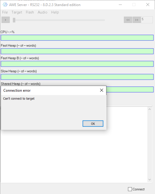

The above looks like the boot was not entirely successful. I did open other COM ports listed above to see if I get any other logs, with the settings mentioned in Step 4 of the User Guide and I see:
Sciserver Testapp Built On: Jul 23 2025 08:55:43
Sciserver Version: v2023.11.0.0REL.MCUSDK.MM.NN.PP.bb
RM_PM_HAL Version: vMM.NN.PP
Starting Sciserver..... PASSED
Starting SD Bootloader ...
SYSFW Firmware Version 11.0.7--v11.00.07 (Fancy Rat)
SYSFW Firmware revision 0xb
SYSFW ABI revision 4.0
which indicates there is a possible firmware mismatch/incompatibility. Also, when I try to connect to AWE server over serial connection (Target -> Change connection -> Connection: RS232), I see the below error as well:

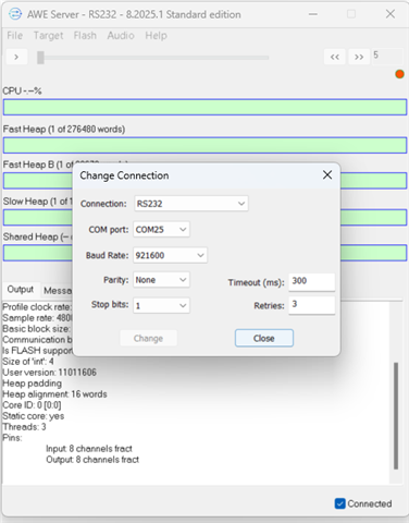

I feel there is a missing step in the setup that I need to do to load the AWE application and test/build the SDK. Could you please help me:
  1. fix the setup and boot the EVM board right
  2. load the desired application and run the right AWE layout?

    • After booting the audio_app on the EVM, Connect UART port to your Windows computer
    • Open AWE designer software
    • Click on Target -> Change Connection
    • Select Connection : RS232
    • COM port : 2nd of the 4 ports
    • Baud Rate : 921600
    Attaching the images for my connection -
    In my case, COM25 is the second COM port and you can see the boot logs in XDS110 Class Application/USER UART(COM8) [ Remember - XDS110 Class Application/USER UART is routed to the JTAG port in AM275. So, you will have to connect the JTAG cable as well to see the boot logs. For connecting via UART, this is not needed.]
  • Hello Ritapravo,
    I have used the binaries that you have provided here. I still see:
    AWE Connection Error
    while my serial ports listed are:
    Serial Ports List
    and I see on COM5:

  • Hello Ritapravo,
    After a bit of trial and error, I figured it was COM8 (the 3rd in the enumerated list of serial ports) that I had use for the connection. Now, I see:
    AWE Connection Success
    Out of curiosity, I would also like to check with you:
    1. if there is a definitive way to identify the right serial/COM port for connection? This could change from system to system, right?
    2. if there is a way to enable to get the logs for AWE connection on target's serial console (other than the AWE server logs)? It would be helpful for debugging.
    Sreekanth
  • Hi Sreekanth,
    From the image you sent, I think COM8 is the second COM port only(COM7 being the first). Maybe windows is doing some lexicographical sorting due to which "COM10" is appearing first. :)
