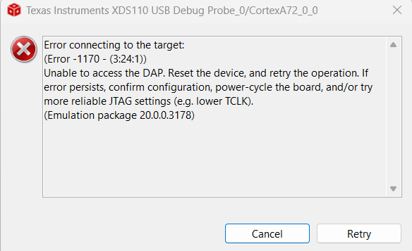

I spent a while trying to connect to a core in the TDA4VM SoC using TDA4VM-SK starter kit and the xds110 debug probe I recently purchased.
I have already checked : https://e2e.ti.com/support/processors-group/processors/f/processors-forum/1178240/faq-sk-tda4vm-how-do-i-connect-the-external-debugger-blackhawk-usb560v2-xds560v2-usb-system-trace-to-the-jtag-on-the-board
and tried this : https://software-dl.ti.com/jacinto7/esd/processor-sdk-rtos-jacinto7/08_04_00_06/exports/docs/psdk_rtos/docs/user_guide/ccs_setup_j721e.html
with ccs v11, v12 and v20 on windows, I could not connect to a single core with "Connect Target" :
I have tried running CCS v10 on ubuntu, this version is requesting python2.7, and could not open ccstudio Error : "there was a problem loading libMiniDump.so"
With Code Composer 20, Connect Target :
IcePick_M_0: Error connecting to the target: (Error -267 @ 0x0) The controller could not detect valid target supply. Check target JTAG connection and/or connection setting specifying voltage level. (Emulation package 20.3.0.3656)
DEBUGSSM_0: GEL: Error while executing OnTargetConnect(): Connect failed
at GEL_Connect() [dbg_util_cid.gel:11]
at ConnectIfDisconnected()
at GEL_EvalOnTarget("IcePick_M_0", "ConnectIfDisconnected()") [dbg_ks3_debugssm.gel:9]
at OnTargetConnect()
CS_DAP_0: Error connecting to the target: (Error -267 @ 0x0) The controller could not detect valid target supply. Check target JTAG connection and/or connection setting specifying voltage level. (Emulation package 20.3.0.3656)
