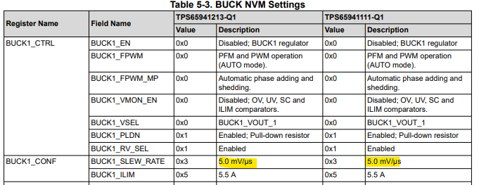

  • observing a ~200 us droop on vdd_cpu, which is driven by 3-phase PDN-0C using TPS6542.  Waveform snip:

    • Strong suspicion that there may be two writes - one with 0x0 (as per log) and second with 0x31 (as per before/after I2C dump), and these two writes could explain the triangular "droop"
Kyle
    Yes, this is the most likely culprit of the triangular droop. The first half of the wave shows 800mV ->400mV in about 80us. That lines up with the 5mV/us slew rate setting for the rail. Similarly, on the rise ~450mV in ~90us is also 5mV/us.

    Edit: Upon some researching it looks like there might be a spurious command in the last capture, see:
    If I am reading the datasheet correct, I see 0x0E 0x05 which translates to set VBUCK1 to 0.4V followed by the 0x0E 0x41 which is 0.85V:
    Does this seem reasonable?
