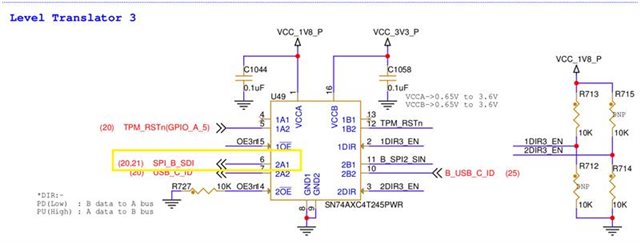

Dear Team,
We are using DRA821U processor in our project. We have connected the 23A512-I/SN SRAM to the DRA821U over SPI.
In the device tree (dts) we have configured the spi-max-frequency as 20MHz, as recommended in the SRAM datasheet. However, during write operations to the SRAM memory block, the write is not happening. We also probed the SPI Clock during the write operation and we are getting only 5.5MHz , instead of 20MHz.
For your reference, we are using mchp23k256.c kernel driver and attached the dts entry of SRAM.

  • Hi Subashini,
    There is a fixed set of baud rates obtainable by the divider for McSPI:
    In any case, could you share the full Linux kernel boot logs from "dmesg"?
    Takuma
  • Hi Takuma,
    As per the reference image, I configured spi-max-frequency to 50 MHz in the device tree and tested the SRAM write operation. However, the write is still not happening.
    During testing, I probed the SPI clock and observed a frequency of 12.5 MHz, not 50 MHz.
    For your reference I have attached dts entry, clock probe image and dmesg log file.
