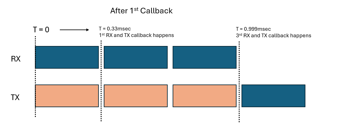

    Pipeline Visualization:
    T=0:         RX Buffer receives input data
    T=0.33ms:    First callback - data submitted to TX queue (Position: 3rd in queue)
    T=0.67ms:    Second callback - data moves up in queue (Position: 2nd in queue)
    T=1.00ms:    Third callback - data is transmitted (Output)
