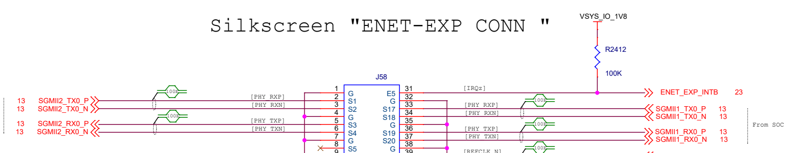

Below is a message that two USXGMII ports can be used among the data sheet contents of TDA4VPE-Q1 and that SGMII3 & 4 can be used.
However, in the EVM circuit diagram below, the circuit is configured as (PROC184E2(002)_SCH.pdf) SGMII1 & 2.
Which port can I use to use 5gbps and 10gbps?
    No. Only CPSW MAC Port-1 and MAC Port-2 alone supports 5G and 10Gbps via XFI/USXGMII interface, and rest of all ports supports only SGMII 1G/2.5G.
    As mentioned above, you can use either MAC Port-1 or MAC Port-2.

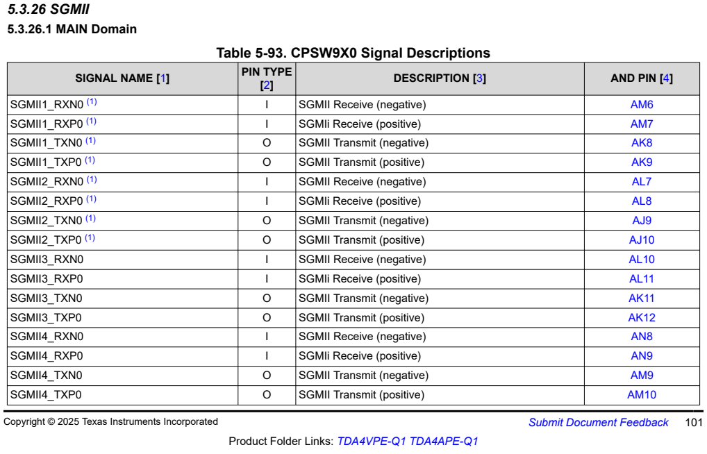

  • So, is the content below wrong in the data sheet?
  • HI,
    As per Data sheet, TDA4xPE6 does not support SERDES2 lanes and TDA4xPE4 does not support SERDES0 and SERDES2 lanes.
    Additionally TDA4xPE4 has muxing limitations for PCIe and SGMII on available SERDES lanes.
    The SERDES and Mux limitations are captured in Pin Attributes Table "VPE4 APE4" column. According to Pin Attributes SerDes1 SGMII lanes are available for using from TDA4xPE4 but PCIe2 lanes are not available as IP supports only two instances of PCIe signals such as PCIe0, PCIe1.
    Attaching a screenshot from Pin Attributes section for your reference.
    Sudheer
