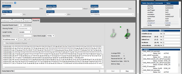

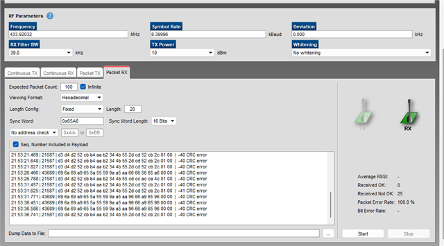

I am using the LaunchXL-CC1310 and trying to read my sensor data in RF Studio under RF Packets mode, but I am not able to see any data. However, I can see spikes in Continuous RX mode.

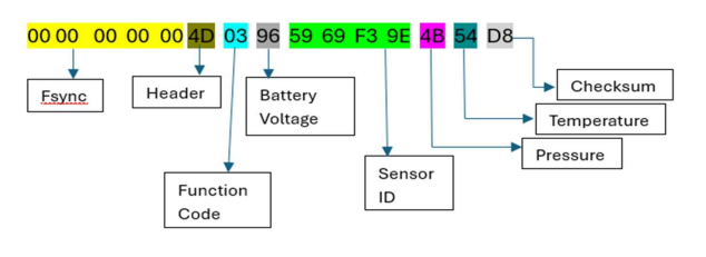

Is it possible that my sensor is not sending data in the format:
[Preamble] → [Sync Word] → [Length] → [Payload] → [CRC (if enabled)]
and that is why it is not being detected in Packet RX mode?
How can I read the raw RF packets?
