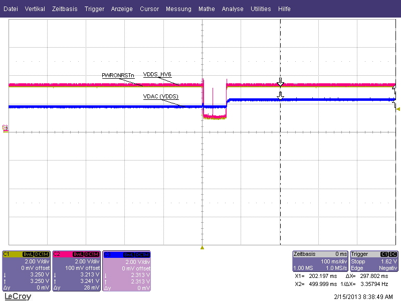

    Trying to reproduce the latch-up situation I have shorted this 3.3V supply for some miliseconds. When doing this strange things happen with the VDDS supply of the PMIC:
    After the short circuit, the VDDS supply rises from 1.8V to 2.3V (!!!) which is above than the absolute maximum rating of 2.1V and this could be the root for the latch-up problem.

    (1) Yes you are right, that is something that will not happen during normal operation.  On the other hand I can't preclude this because this supply is connected to debug headers. As a matter of fact 4 out of 10 prototype boards suffer from a latch-up damage and I'm desperately trying to find the reason for that.  I'm not able to reproduce that latch-up and I do not understand what happens exactly.  At the moment all I can say is that these defective boards
    - all boards have been  "healthy" after production
    - are still booting without strange behaviour regarding the function of the software
    - have an increased power consumption and the AM3359 is getting approx. 10°C hotter than on a "healthy" board
    - do have reduced input resistances at the VDDS and the VDDSHV6 supplies
    - are NOT having this strange increasing of the VDDS supply after a 3.3V drop that I've tried to explain above.
    Could you please review the block diagram and tell me if you think that something is wrong. Any comment on that latch-up issue is highly appreciated!

  • reto,
    Is the problem solved now? Is it possible that the root cause lays in power down sequence instead of the power up sequence?
    In your design, 3.3V  VDDSHV is supplied by an external buck while 1.8V VDDS is supplied by 65910A3.
    The power up sequence is quite okay because the 3.3V output is only enabled when VMMC exceeds 1.2V (which is the threshold of ENABLE of 54218).
    But during power down procedure, 54218 can still work until the nominal 3.3V VMMC drops to 1.2V.
    335x requires that the VDDSHV can not exceed VDDS more than 2V otherwise serious consequences may be caused. But using a separate buck cannot 100% guarantee this given the bulk capacitor being placed at the input and output of the buck circuit.
