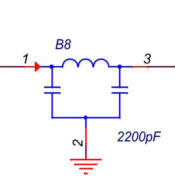

In the EVM schematics, there is one kind of component showed in the below image
And I want to know how to determine the inductor and capacitor's values. Are there any TI's documents about this situation?

The part used for the EVM is a Murata EMI capacitive filter part number NFM18CC222R1C3. You can find the charactoristic behavior of this component in the data sheet which can be found on the Murata website.
Hi Bill,
The EVM shows p/n NFM18CC222R1C3, which has 2,200pF capacitance.
The Keystone HW Guide SPRABL2B (table 14) states p/n NFM18CC223R1C3, which has 22,000pF capacitances.
Which is correct?
David
Hi David,
The choice of device depends on the amount and the frequency of the noise in your system. The more aggressive 22,000pF device will filter starting at frequencies lower then the 2200pF device used on the EVM. Take a look at the data sheet for these devices and you will see the frequency characteristics. The EVM was successful with the less aggressive 2200pF device so we never changed it to the 22,000pF device.
