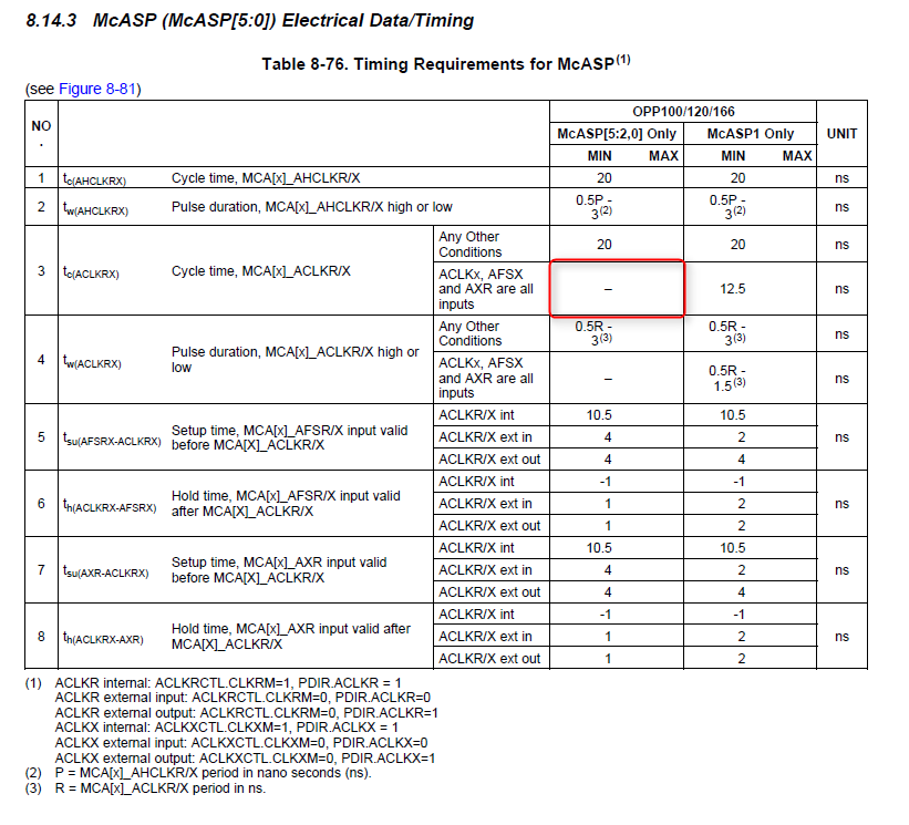

How fast can we run the McASP on the DM8148, datasheet is missing cycle time spec
The DM8148 Sep 2012 datasheet is missing cycle time for McASP
Table 8-76. Timing Requirements for McASP(1)
NO.                                                                                                                                                         McASP[5:2,0]         Only McASP1 Only               UNIT
3              tc(ACLKRX) Cycle time, MCA[x]_ACLKR/X               ACLKx, AFSX and AXR are all inputs                  –                              12.5                         ns
We’re using ACLKx, AFSX and AXR as inputs, so how fast can the McASP run?
