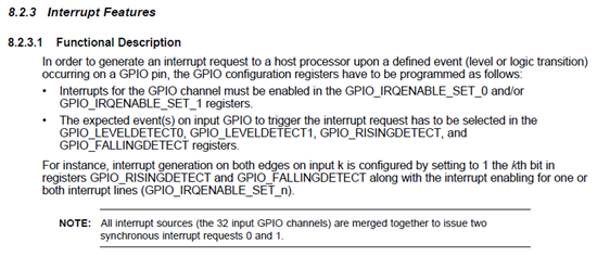

Note: General-Purpose Input/Output (I/O) pins can also serve as external interrupt inputs.
How many external interrupts can I configure with the AM3892?

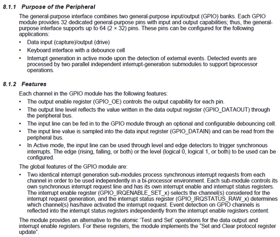

Every GPIO can be used to trigger an interrupt on the host processor. The images were taken taken from the TRM.

The TRM and datasheet states we can configure all 64 GPIO pins as external interrupts.

This is the official TI81xx GPIO driver user guide: http://processors.wiki.ti.com/index.php/TI81XX_PSP_GPIO_Driver_User_Guide, see section 3 IRQ handling
Also you can refer to the below wiki pages, which are for old Davinci devices, but the approach can be reused for DM816x/AM389x :
http://processors.wiki.ti.com/index.php/Configuring_GPIO_Interrupts
http://processors.wiki.ti.com/index.php/Avoiding_Double_Interrupts_with_the_GPIO_Peripheral

The question was referring to the generic control of the GPIO’s. In the part there are 64 GPIOs.
In your response, you referenced the bank 0 and 1 above (e.g. GPIO0.GPIO_IRQSTATUS_RAW_0 vs GPIO1.GPIO_IRQSTATUS_RAW_0). I believe you misunderstood my question.
64 GPIO’s require at least two 32 bit registers to control each of the identified functions. Looking again at the register map above from the TRM, there is additional register space from 158h to 18C. Are the additional registers in this offset area? What are the correct offset addresses of the additional registers?

We do not have 64 GPIOs, we have 64 GPIO pins which are controlled from only 2 GPIO controllers (GPIO0 and GPIO1).
No additional registers.
First 32 GPIO pins (GP0[0] to GP0[31]) are controlled from GPIO0 registers (0x48032000 + offset). Second 32 GPIO pins (GP1[0] to GP1[31]) are controlled from GPIO1 registers (0x4804C000 + offset).
