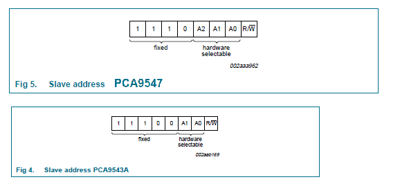

  • Hi Eric,
    You mentioned that the slave address is 0x73; So the A0 and A1 input lines are pulled high and A2 is grounded ?
    As per your hardware, how are these lines (A0,A1,A2) connected?
    If all these lines are grounded, the address should be framed as 0b01110000 --> 0x70 ;If all are pulled high, the address will be 0x77.
    If 7th channel needs to be accessed, then the control register should also be configured appropriately.
    What are the slave device connected to 7th channel. Whether the modification for pca9547 is done in the board file with reference to pca9543?
    Please share your board file and the bootlogs with error messages.
    Shankari
