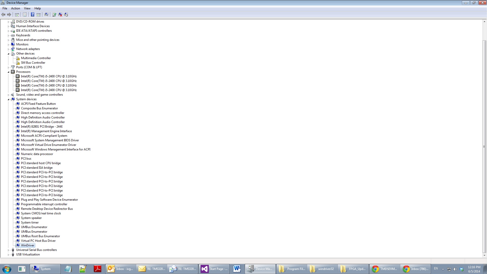

Hi ,
I have programmed the FPGA with”C6657 Gauss EVM_FPGA_v02.bit” file.
I have set the DIP switches to ROM PCIE Boot.
I have connected the 6657EVM to the PCIe slot on the motherboard
The 6657 EVM is recognized as
Multimedia controller Texas Instruments
Where can I find a windows 7 driver ?
Is any driver is available to work with 6657 EVM after detecting it on PC using TMDXEVMPCI ?
