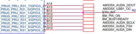

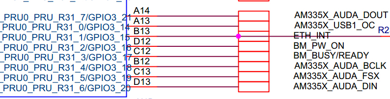

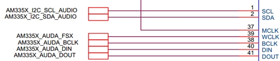

I work on a custom AM3352 board designed as Start-kit board,and the audio chip is TLV320AIC3106 ,the software is SDK6.0.I have modified the pin mux code ,because the hardware circuit is changed,

I power on the board,the boot message is like this:
[ 1.648559] tlv320aic3x-codec 1-001b: Failed to get supply 'IOVDD': -19
[ 1.655517] tlv320aic3x-codec 1-001b: Failed to request supplies: -19
[ 1.662231] tlv320aic3x-codec 1-001b: asoc: failed to probe CODEC tlv320aic3x-codec.1-001b: -19
[ 1.671356] asoc: failed to instantiate card AM335X EVM: -19
[ 1.677307] ALSA device list:
[ 1.680389] No soundcards found.
I can read the TLV320AIC3106 registers correctoly via I2C0,so i am sure the I2C is ok . Anything i miss?
