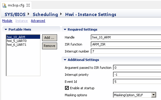

When I tried to add new hwi into SYSBIOS I've got a strange error:
Failed to plug: &ARM_ISR. Hwi 7 already in use by: &ti_sysbios_family_c64p_EventCombiner_dispatch
I tried to insert any other interrupt numbers 7-10 but I've got the same error. I have no ideas what is wrong.
When I make a new project I can make this interrupt easily.
