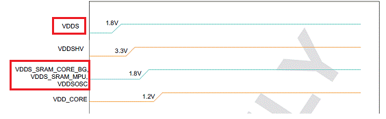

I our application the power sequence is designed as per the Reference Design (SLVA411).
In which VDDS(1.8) is ramped up first and VDDSHV(3.3) next and then VDDS_SRAM_xxx(1.8)
as shown below.
Whereas, the AM3505 datasheet mentions
"VDDS and LDO supplies (VDDS_SRAM_CORE_BG, VDDS_SRAM_MPU)
and oscillator supply (VDDSOSC) should come up first to a stable state. "
We can understand the datasheet is the correct one but our design is bit old which
was based on the older version of datasheet(2009) and the Reference Design.
Could you please let us know if this design is wrong and should we re-design the
sequence according to the latest datasheet(which is difficult now)?
Actually all the design guides TPS65073/TPS65023 are as per the older datasheet.
Will it be OK to continue with the older design?

    I will ask the factory team to comment what was the reasoning behind these changes in sequencing.
  • If VDDS is the first powered up, there is no issue in powering VDDS_SRAM_xxx, VDDSOSC later. As also noted in the App note, if there is a common 1.8V powering all these rails, you can also combine them.
    Regards, Siva
  • Hi Biser and Siva,
    Thank you very much for the confirmation. This info is very helpful.
    We shall continue with the below sequence.
    Please let us know if there is anything missing.
    Best Regards
    Kummi.
  • Your sequence looks fine. Make sure you also follow proper power-down requirements as in the data sheet
    Regards, Siva
