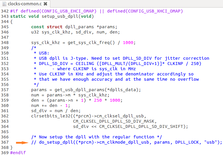

I used VisionSDK_V2.9 on TDA2Ex echo evm, System response:
With the following modify(orange arrow) can be started:
VISION_SDK_02_09_00_00/ti_components/os_tools/linux/u-boot/u-boot/arch/arm/cpu/armv7/omap-common
But to get the USB device it failed:

Also try to update Filesystem tarballs (GLSDK 7_03_00_03), But did not solve.
Why 'DPLL locking failed for 4a008180' occurs? How to solve?
