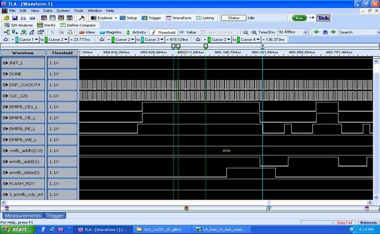

Hello, I am using TMS320C6415 and have an intermittent issue where the device hangs during power up and does not complete the boot process.  The issue occurs at all temperatures.  I have attempted to attach an emulator to read the EMIFB and EDMA registers but I am unable to connect to the device when it is in a failed state.  The device bootmode is set to EMIFB 8-bit ROM boot.  The EMIFB input clock is set to CPU/4 Clock rate.  The failure appears to happen either at the end of the 1K byte transfer from Flash using the internal boot loader, or somewhere in the middle of the second boot transfer from flash that is setup using the code that is contained in the first 1K bytes that is transferred using the internal boot loader.  The flash device is PC28F256M29EWLA.  Below are logic analyzer captures at the end of the 1K boot transfer for a passing and failing condition.  In a failing condition, the DSP device drives EMIFB_WE_L active.  This signal should not be active as the device is still in the process of reading boot code from the flash device.  The reset to the DSP device is being driven from an FPGA.  During power on the reset is held in the active state through a reset monitor, then after the FPGA configures it drives a reset pulse to the DSP that occurs 50 ms after power on reset, the reset pulse is about 800 us wide.  Any help on where to look or what would cause the DSP to intermittently drive EMIFB_WE_L active during the boot process would be greatly appreciated, thank you.
Passing condition at end of 1K byte boot transfer, secondary boot transfer starts:
Failing condition, EMIFB_WE_L drive low for unknown reason at end of 1K boot transfer, secondary boot transfer never starts:

    C1. In both screen shots, it appears that when CE1 goes from 0 on the far left to 1 near the middle, that is the end of the 1K auto-transfer.
    C2a. In the passing case, CE1 appears to be high about 550ns, at which time it appears that the EMIFB timing has been optimized and new reads are starting; also D0 goes high at about the 400ns point after CE1 goes high.
    C2b. In the failing case, the time from CE1 / to A1 \ is only 186ns and the WE \ happens at 310ns from CE1 /.

    Q1. Which other CEx are you using? The fact that D0 and A1 are toggling without CE1 being low implies that the EMIFB is trying to drive another memory space.
    Q2. Or is there another bus master on EMIFB?
    Q3. How repeatable is the failure? On how many boards, out of how many never fail?

  • Thank you Randy for the response and info.  Below are answers to your questions and comments:
    C1. In both screen shots, it appears that when CE1 goes from 0 on the far left to 1 near the middle, that is the end of the 1K auto-transfer.  That is correct, that is what we believe also.
    C2a. In the passing case, CE1 appears to be high about 550ns, at which time it appears that the EMIFB timing has been optimized and new reads are starting; also D0 goes high at about the 400ns point after CE1 goes high.  Exactly right, the code in the 1K initial boot sector has now optimized the Flash access timing for the second 16K boot transfer because it now knows which flash device it is talking to.
    Q1. Which other CEx are you using? The fact that D0 and A1 are toggling without CE1 being low implies that the EMIFB is trying to drive another memory space.  All 4 EBIFB CEs are routed from the DSP to FPGA, the FPGA then routes to the appropriate devices on the EMIFB Bus.  CE0 is routed to a UART in FW, CE1 is routed to the boot flash, CE2 is routed to a different memory, CE3 is routed to a transceiver chip.
    Q2. Or is there another bus master on EMIFB?  No other masters on EMIFB, only the DSP
    Q3. How repeatable is the failure? On how many boards, out of how many never fail?  We currently have about 20 failing boards, the failure started occurring more frequently on boards assembled mid-late last year.  Roughly a 10-20% failure rate based on total # of boards.  The failure is intermittent on all boards, failure rate ranges from about 10%-50%.
    D1. If you raise or lower temperature or voltage, does it affect the repeatability of the failure?  Different boards exhibit this failure at different temperatures, a majority of the boards fail at either a hot or cold temperature extreme.  A few boards fail at ambient and those are the boards we have been debugging with due to ease of probing signals and testing.
    D2. Perhaps depending on Q3, it could help to put some pin-toggling into the 1KB initial boot code to see if anything valid starts to run, and how far into the code it gets. Toggling a GPIO might be best, or doing a dummy read could be enough to get a little observability inside the secondary boot operation.  Haven't tried this yet, but yes good suggestion, will need to get someone from our SW group to modify the boot code which might take a few days.
    D3. Perhaps depending on Q3, you could have CCS connected and apply a reset from within CCS that will trigger a hardware re-boot.  Haven't tried this yet either.
    D4. Can you apply repeated resets from the FPGA and just observe the failure rate? It would be interesting to see if the failure rate is tied to being right after power-on or not. The PLL setting could be a factor, too.  The failure does occur if a board level reset is applied to the board several minutes after power up.  This board reset also triggers a reconfigure of the FPGA.  So it does not appear to be tied only to a power up condition.
    Thanks again for your info and suggestions, any further suggestions or info would be greatly appreciated.
