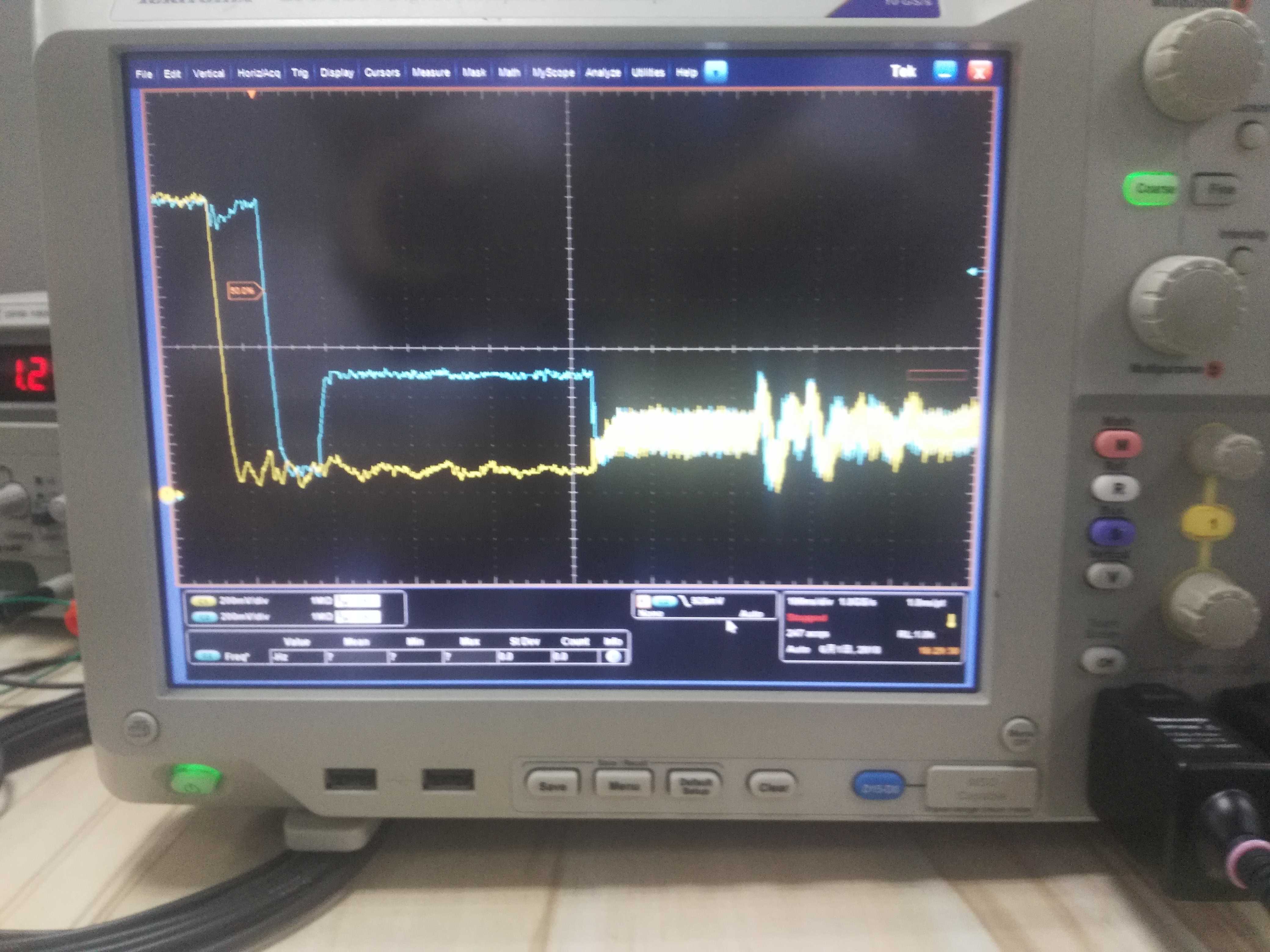

  • Hello Nikhil,
    Thanks your quick response!
    I tried your suggestion,but unfortunately, the issue is same as before. register 0x489b0304 bit 29 always keeps '0' -- reset is on going.
    omapconf read 0x489b0304
    4A054321
    I tried both manually and with callback to close/open CSI2 port. The procedure is as below:
    1. I increase checking times of reset done bit (for examples 5000 times) in CAL function: csi2_wait_for_phy, and set CSI2 of 964 to off in FPD driver, only after issued yavta capture command, i will manually set CSI2 to on through i2c tool, and from oscilloscope, I make sure MIPI signal is generated.
    2. I also tried put the above manual operation into ov1063x_s_stream function, only after the stream is on, i will set CSI2 of 964 to on.But result is still same.
    I tried the above cases with ctx->external_rate = 200MHz & 400MHz respectively.
    Below picture is the mipi clock signal captured from oscilloscope:
    Do you have any other suggestions? Thanks a lot!
    David
  • Hi David,
    That is the only dependency on the PHY reset. HW should automatically detect the state transitions and set the reset done bits.
    Nikhil D

  • Hello Nikhil,
    The Linux CAL driver is working now in my board, the issue is that all lanes (4 data  + 1 clock ) polarity  are swapped, origin setting is for +/-, actual connection is  -/+ . Previously I was told using +/- polarity. BTW, during capturing, bit 29 should always keep 1.
    David
  • Glad to know the issue is resolved
