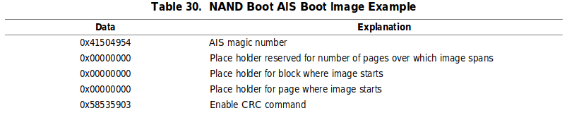

2. NAND's AIS there are 3 fields after Magic Number, that are not completely documented:
I checked genAIS.pl script without luck. I have a block size of 0x40 pages. If my sample AIS fits into single page and is programmed into 1-st block, than I should use here 0x1, 0x1, 0x0? Or maybe 0x1, 0x1, 0x40?

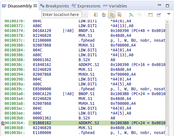

Anyway, since ROM code can be debugged I end up digging into disassembly. Looks like code is compiled without optimization. Though it is going to be quite time consuming I guess I can solve my issues by debugging ROM code.

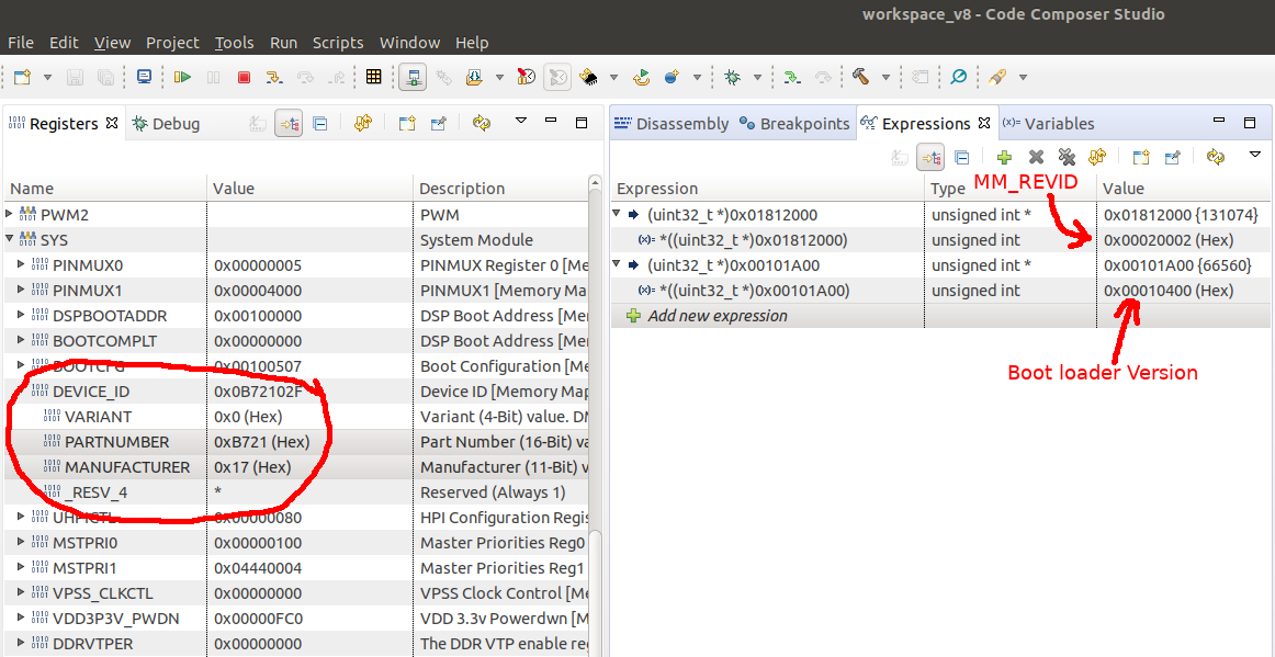

  • Hello Yordan,
    looks like I have boot rom version 1.40. Check out a screen shot:
    I believe this note refers to actual chip silicone revision. See Figure 2-14. Device Nomenclature in the TMS320C6424 datasheet:

    > (no debug options)
    well, I guess that boot rom is build with optimization disabled. Check out following assembler lines from the boot rom:
    Very same constant has been calculated 2 times in row and put into A4 at lines 0x00100394 and 0x001003a8. This code looks for me like
    if (fnc_ptr) {
        fnc_ptr();
    where calculated constant is fnc_ptr address. I would expected this to be optimized into a single const calculation instead for C code. Not sure this guess is correct though.

    1. "Large" (see source code) page flash: I have 2048 B per page flash
    For these assumptions I got following:
    1. All AIS is written in little endian bytes order to NAND
    2. All NAND related meta data is written in little endian bytes order except ECC
    3. Separate ECC value per 512 Bytes, 4 ECC values for 2KB page
    4. AIS number of pages: actual number of pages (AIS image / 2KB for me)
    5. AIS block start: actual start block (block 0 is not allowed in ROM code)
    6. AIS page start: always zero
    Check out my spare area layout that worked for me:
