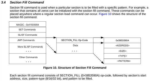

Dear TI Support team,
AIS Section Fill command is not documented properly. Here is what I found at spraak5b.pdf:
Did not find any related info in a genAIS.pl (both v1.05.00 and v1.20.10 versions) and github.com/.../AISGen.cs
I found following AIS Section fill command discussion for TMS320C6747/45/43 DSP: https://e2e.ti.com/support/processors/f/791/p/118006/423501
Could you please:
Kirill
  • Kirill,
    Yes, SECTION_FILL command is supported by the ROM on this device and is referred to in the genAID.pl script  but the details are not in there. Section fill for DM643x/C6424  is same as C6747 device  and the details are in the Bootloader application notes:
    The Case statement to process SECTION_FILL command in the AIS protocol is as follows:
         case AIS_PROTOCOL_SECTION_FILL:  //10
            sectionLoadAddr = (Uint32 *) readWord(&currAddr);
            sectionSize     = (Uint32)   readWord(&currAddr);
            j = (sectionSize % 4);
            dataWord = readWord(&currAddr);
            for(i = 0; i < sectionSize/4; ++i)
              sectionLoadAddr[i] = dataWord;
            if (j != 0)
              byteAddr = (Uint8 *)(sectionLoadAddr+i);
              for(i = 0; i < j; ++i)
                byteAddr[i] = dataWord & 0xFF;
                dataWord >>= 8;
    Hope that helps.
    Rahul
  • Dear Rahul,
    According to code you have posted arguments to the section fill are actually:
    1. Address
    2. Size in Bytes
    3. Pattern for word access
    4. Pattern for per byte access
    There is No type argument.
